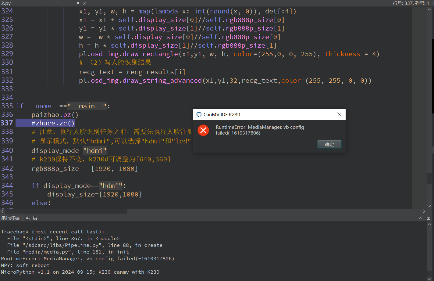

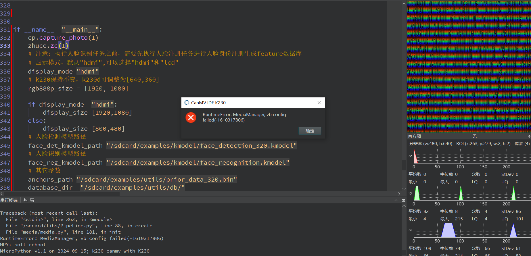

我改写了例程中用图片注册人脸的程序,变成以RGB888注册,注册是可以在人脸识别例程中成功使用的;
但是注册完人脸数据后,帧缓冲区会变成这样(如下图帧缓冲区);
你新添加的代码中有占用没有释放。
请问要添加什么代码段释放呢?
这个我也不清楚,需要根据你的代码具体去调,原来try...except...finaly的内容就是释放的过程,如果在try之前推出,那就会导致这个问题。
我测试后发现,不是注册问题,而是拍照以后会导致的问题下面是人脸识别的程序,我只在主函数里添加了pz()拍照的函数,就会报错

下面是拍照的代码
# Camera Example
# Note: You will need an SD card to run this example.
# You can start camera preview and capture yuv image.
import time, os, sys
from media.sensor import *
from media.display import *
from media.media import *
# save image raw data, use 7yuv to preview
class si:
    def save_img(img, chn):
        if img.format() == image.RGB888:
            suffix = "rgb888"
            suffix = "unkown"
        filename = f"/sdcard/examples/utils/rgb888_img/camera_chn_{chn:02d}_{img.width()}x{img.height()}.{suffix}"
        print("save capture image to file:", filename)
        img.save(filename)
class paizhao:
    def pz():
            print("camera_test")
            sensor = Sensor()
            # sensor reset
            sensor.reset()
            # set hmirror
            # sensor.set_hmirror(False)
            # sensor vflip
            # sensor.set_vflip(False)
            # set chn0 output size, 1920x1080
            # set chn0 output format
            # bind sensor chn0 to display layer video 1
            # set chn1 output format
            sensor.set_framesize(width = 640, height = 480, chn = CAM_CHN_ID_1)
            sensor.set_pixformat(Sensor.RGB888, chn = CAM_CHN_ID_1)
            # use hdmi as display output
            Display.init(Display.LT9611, to_ide = True)
            # init media manager
            MediaManager.init()
            # sensor start run
            sensor.run()
            # drop 100 frames
            for i in range(100):
                sensor.snapshot()
            # snapshot and save
            img = sensor.snapshot(chn = CAM_CHN_ID_1)
            si.save_img(img, 1)
            print(f"user stop")
        except BaseException as e:
            print(f"Exception '{e}'")
        finally:
            # sensor stop run
                sensor.stop()
            # deinit display
            Display.deinit()
            time.sleep_ms(100)
            # release media buffer
            MediaManager.deinit()
下面是报错内容
所有的代码中MediaManager.init()只能调用一次,你在pz函数中已经调用,后面再调用就会报错
