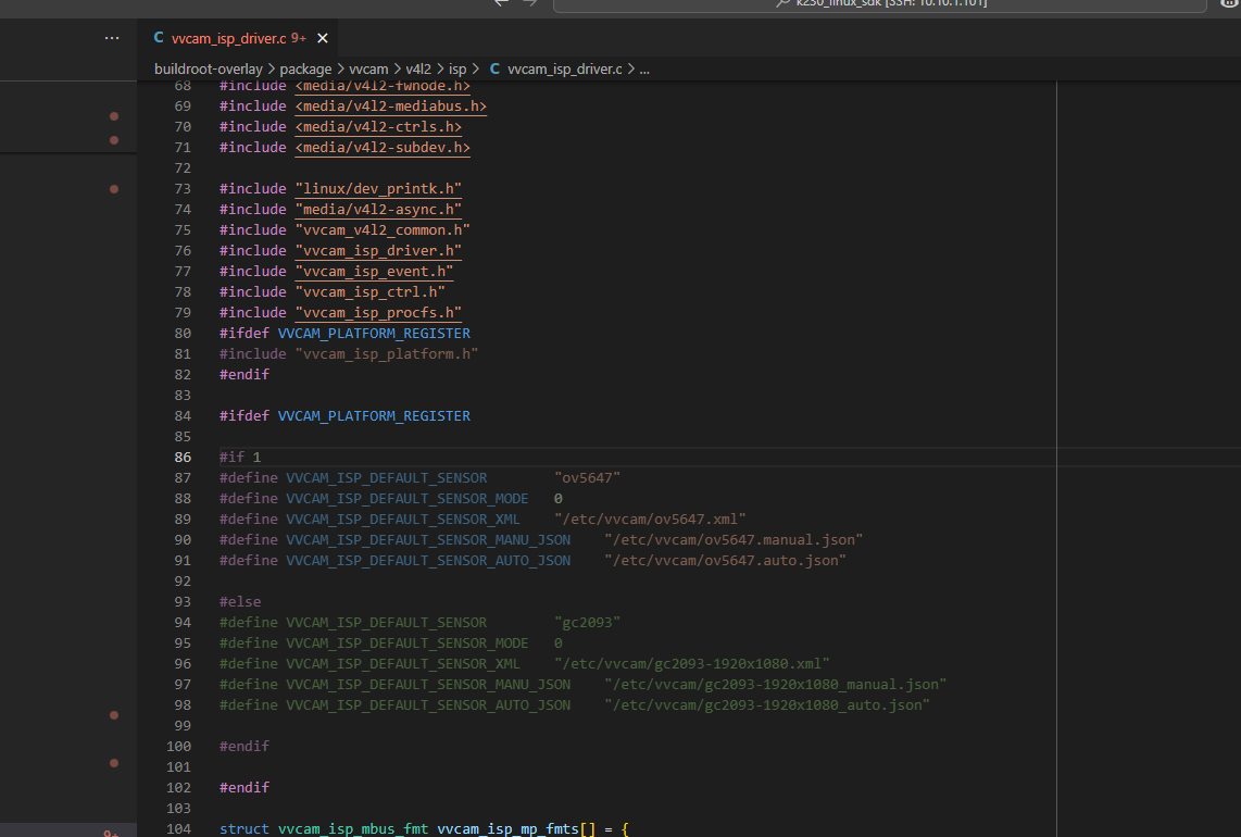

I think i config sensor incorrect. (board use GC2093 on CSI2, default)
Please check help me!
Thanks!
3 Answers
After modifying the code, you need to run make vvcam-rebuild; make.
It is recommended to power off and restart the device.
Thank for your rep!
I follow link above, but not yet successful.
cat /proc/vsi/isp_subdev0
/sensor configuration/
isp0 port0:
sensor : gc2093
mode : 0
xml : /etc/vvcam/gc2093-1920x1080.xml
manu_json: /etc/vvcam/gc2093-1920x1080_manual.xml
auto_json: /etc/vvcam/gc2093-1920x1080_auto.xml
sensor config show is port0. But, i connect GC2093 with CSI2 -> so with my case: Will it be port0 or port2?
And how can i config CSI port image sensor for vvcam isp?
Currently, only CSI2 is supported, and this display is correct.
Thank you so much, i fix it ok!
