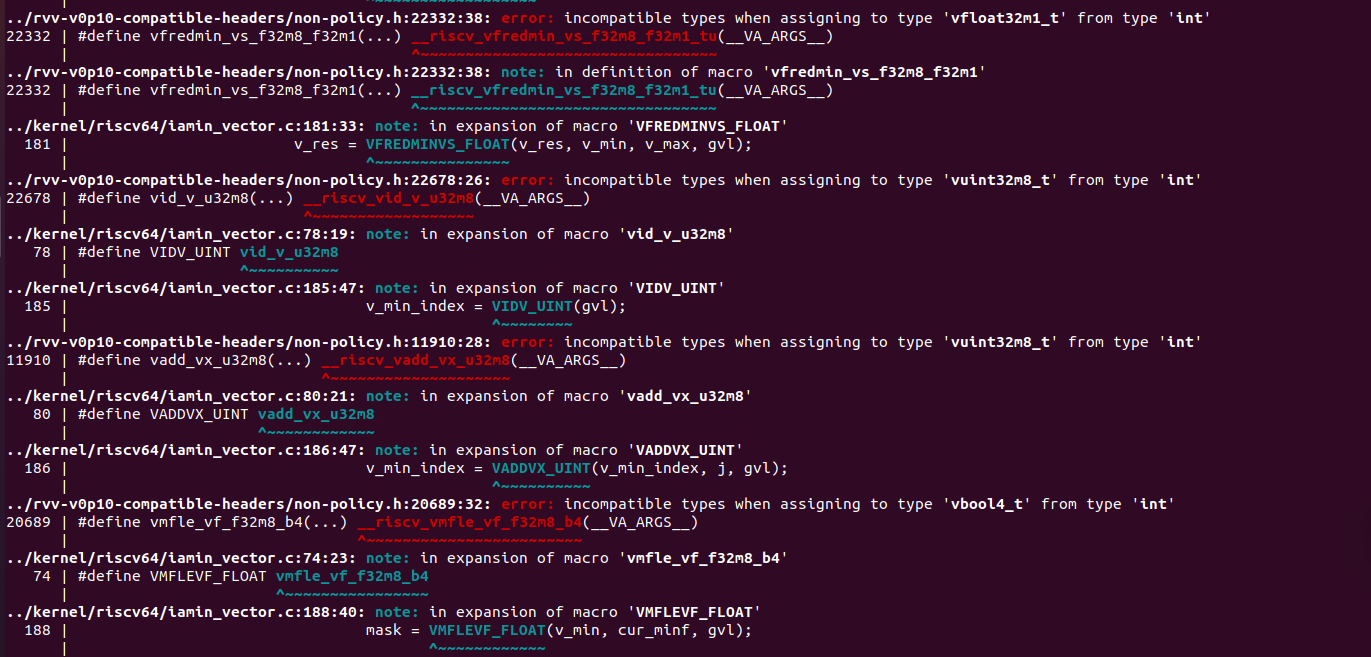

../rvv-v0p10-compatible-headers/non-policy.h:11910:28: error: incompatible types when assigning to type 'vuint32m8_t' from type 'int'
11910 | #define vadd_vx_u32m8(...) __riscv_vadd_vx_u32m8(__VA_ARGS__)
../kernel/riscv64/iamin_vector.c:80:21: note: in expansion of macro 'vadd_vx_u32m8'
   80 | #define VADDVX_UINT vadd_vx_u32m8
../kernel/riscv64/iamin_vector.c:186:47: note: in expansion of macro 'VADDVX_UINT'
  186 |                                 v_min_index = VADDVX_UINT(v_min_index, j, gvl);
../rvv-v0p10-compatible-headers/non-policy.h:20689:32: error: incompatible types when assigning to type 'vbool4_t' from type 'int'
20689 | #define vmfle_vf_f32m8_b4(...) __riscv_vmfle_vf_f32m8_b4(__VA_ARGS__)
../kernel/riscv64/iamin_vector.c:74:23: note: in expansion of macro 'vmfle_vf_f32m8_b4'
   74 | #define VMFLEVF_FLOAT vmfle_vf_f32m8_b4
../kernel/riscv64/iamin_vector.c:188:40: note: in expansion of macro 'VMFLEVF_FLOAT'
  188 |                                 mask = VMFLEVF_FLOAT(v_min, cur_minf, gvl);

是不是当前openblas不支持rvv1.0的版本,在玄铁提供的编译器函数和openblas做向量计算的函数定义的输入参数类型不一样
