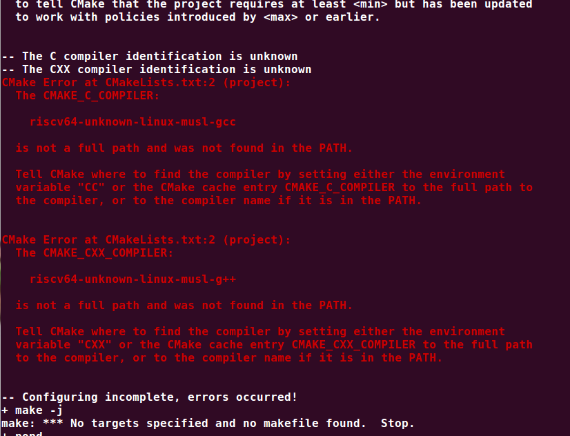

请问k230_SDK编译opencv找不到编译器路径怎么处理,需要修改哪个文件?跪谢
Viewed 313

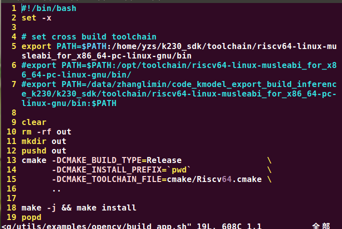

1.按照官网步骤安装工具链
2.拉取docker镜像
3.按照opencv开发指南编译
成功编译出可执行文件
似乎是编译器路径错误
canmv-k230-lp4 v3.0
k230_sdk v1.6
-- The C compiler identification is unknown
-- The CXX compiler identification is unknown
CMake Error at CMakeLists.txt:2 (project):
The CMAKE_C_COMPILER:
riscv64-unknown-linux-musl-gcc
is not a full path and was not found in the PATH.
Tell CMake where to find the compiler by setting either the environment
variable "CC" or the CMake cache entry CMAKE_C_COMPILER to the full path to
the compiler, or to the compiler name if it is in the PATH.
The CMAKE_CXX_COMPILER:
riscv64-unknown-linux-musl-g++
variable "CXX" or the CMake cache entry CMAKE_CXX_COMPILER to the full path
to the compiler, or to the compiler name if it is in the PATH.
