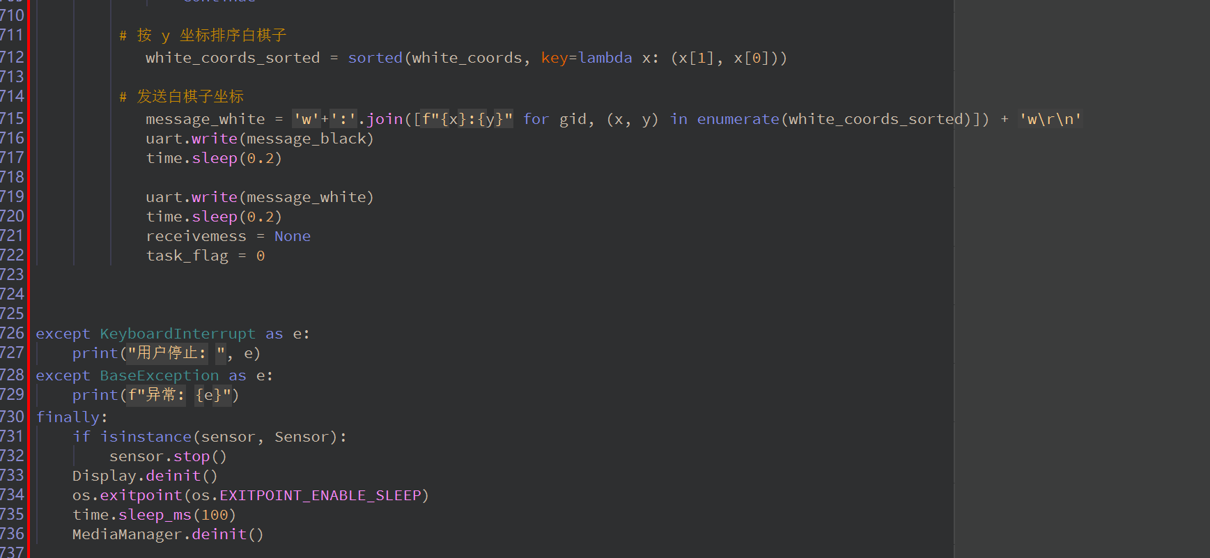

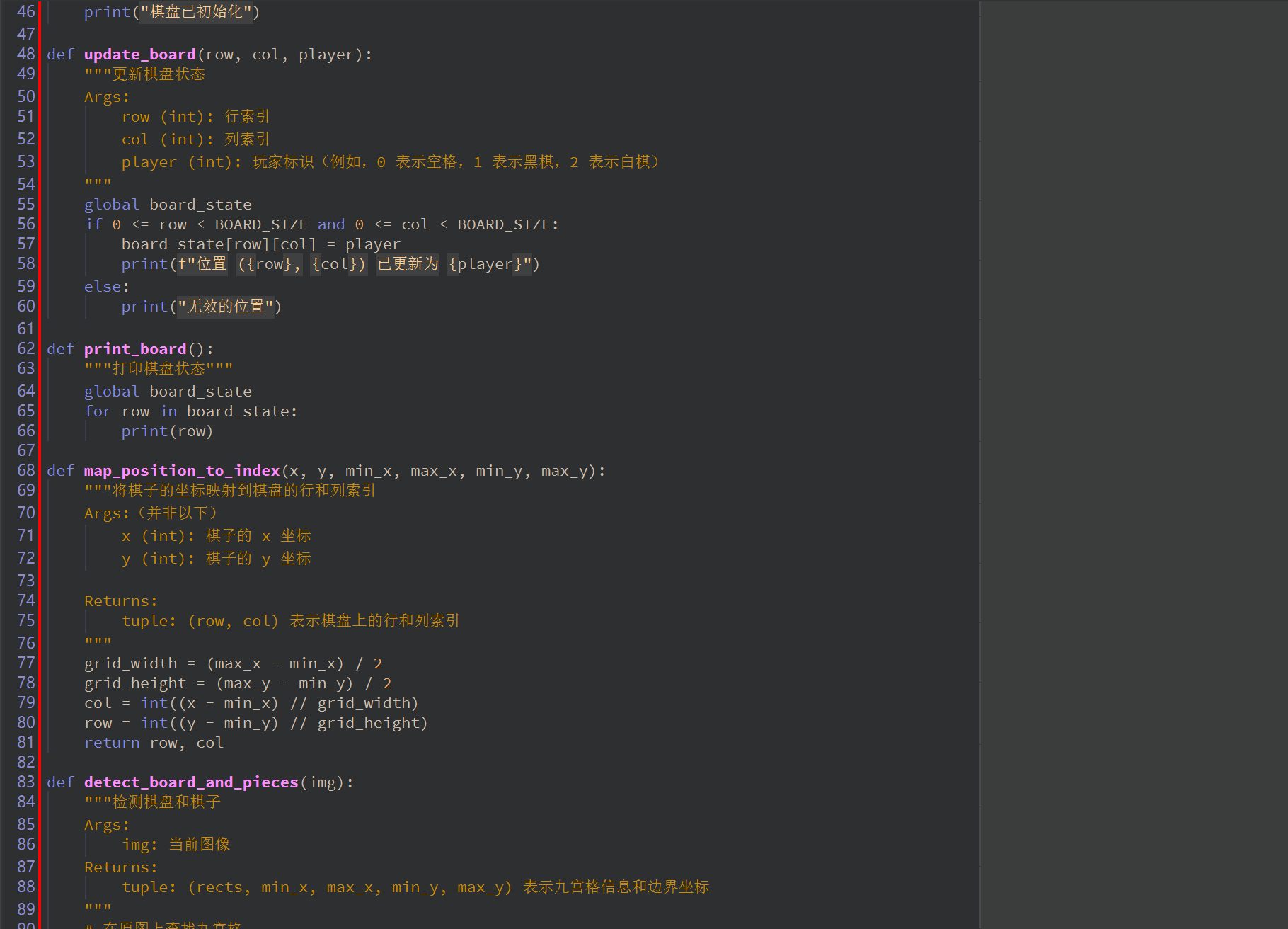

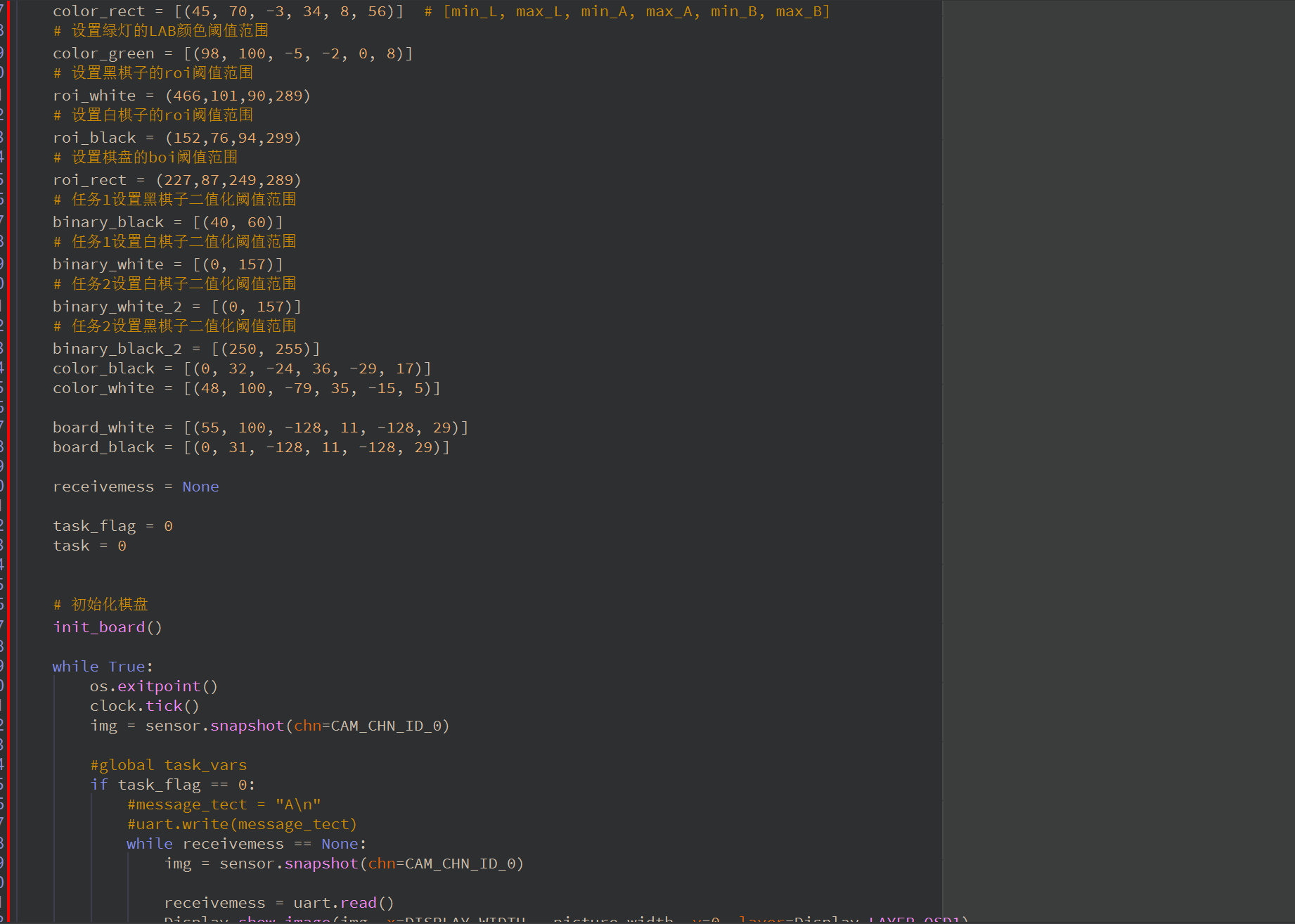

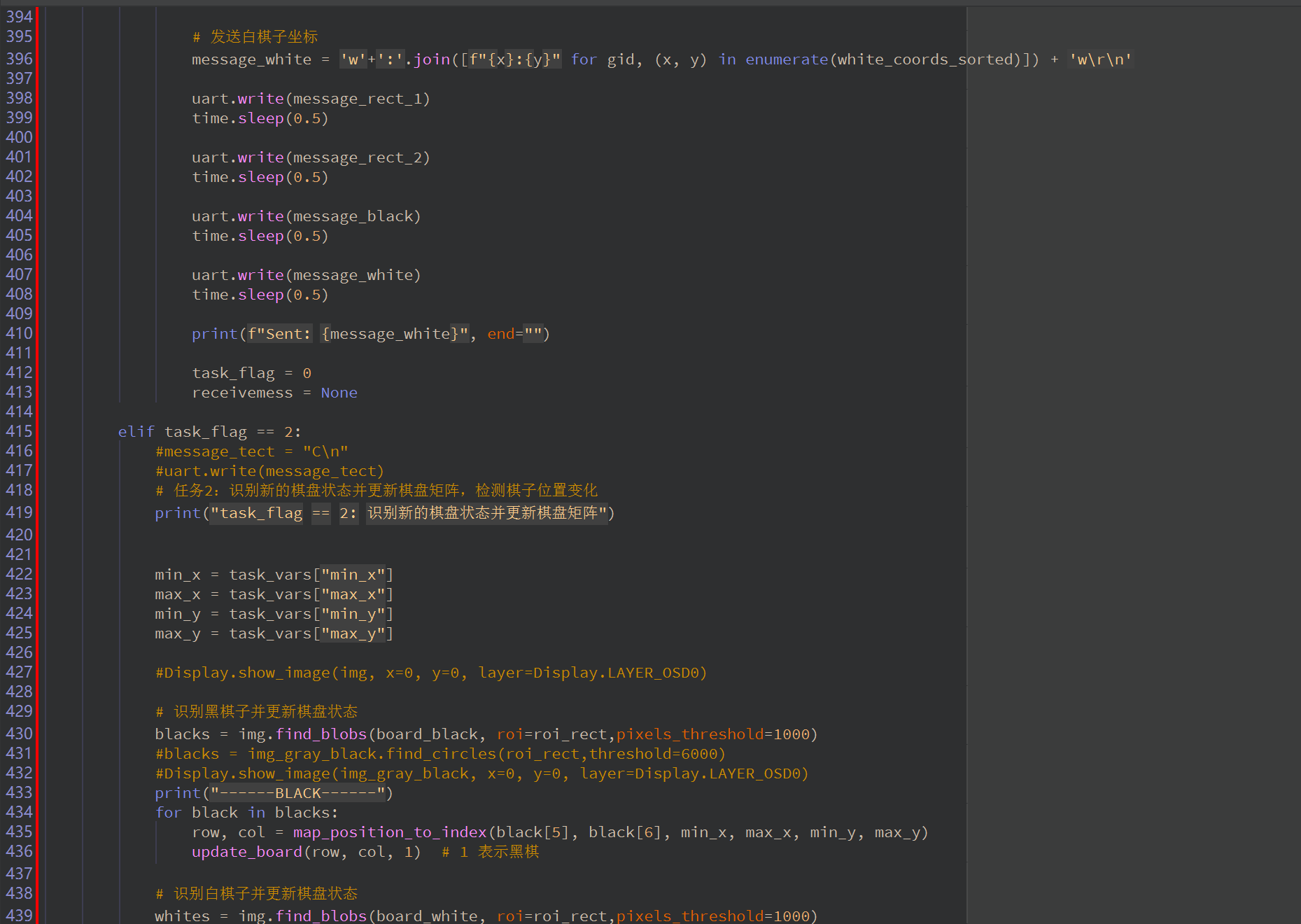

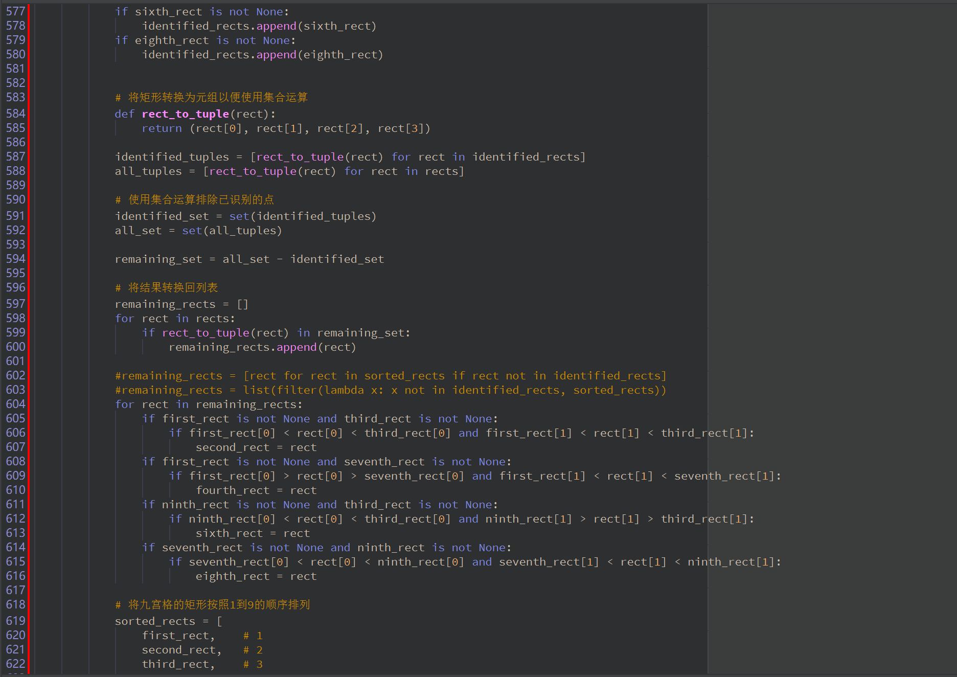

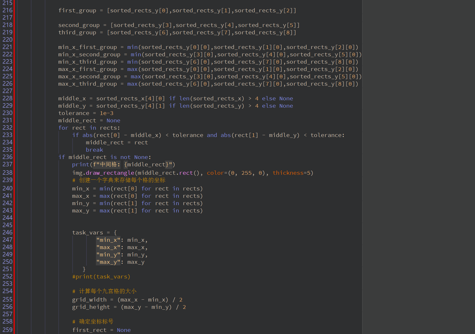

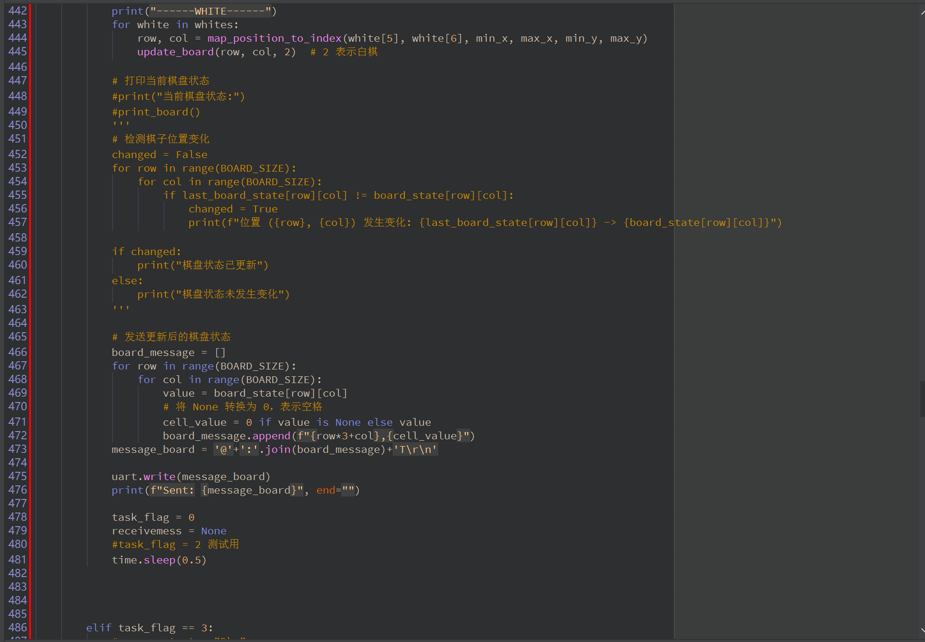

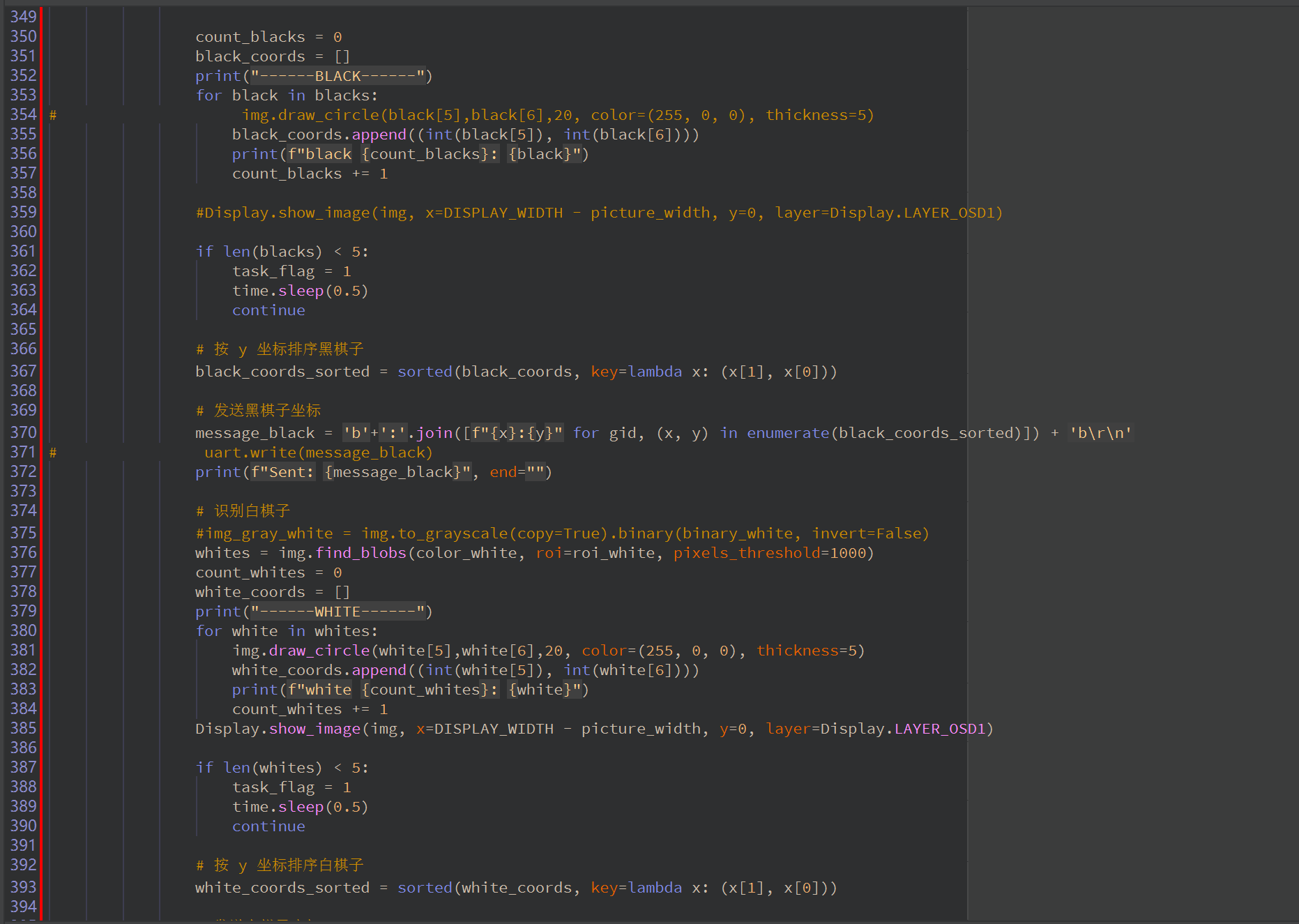

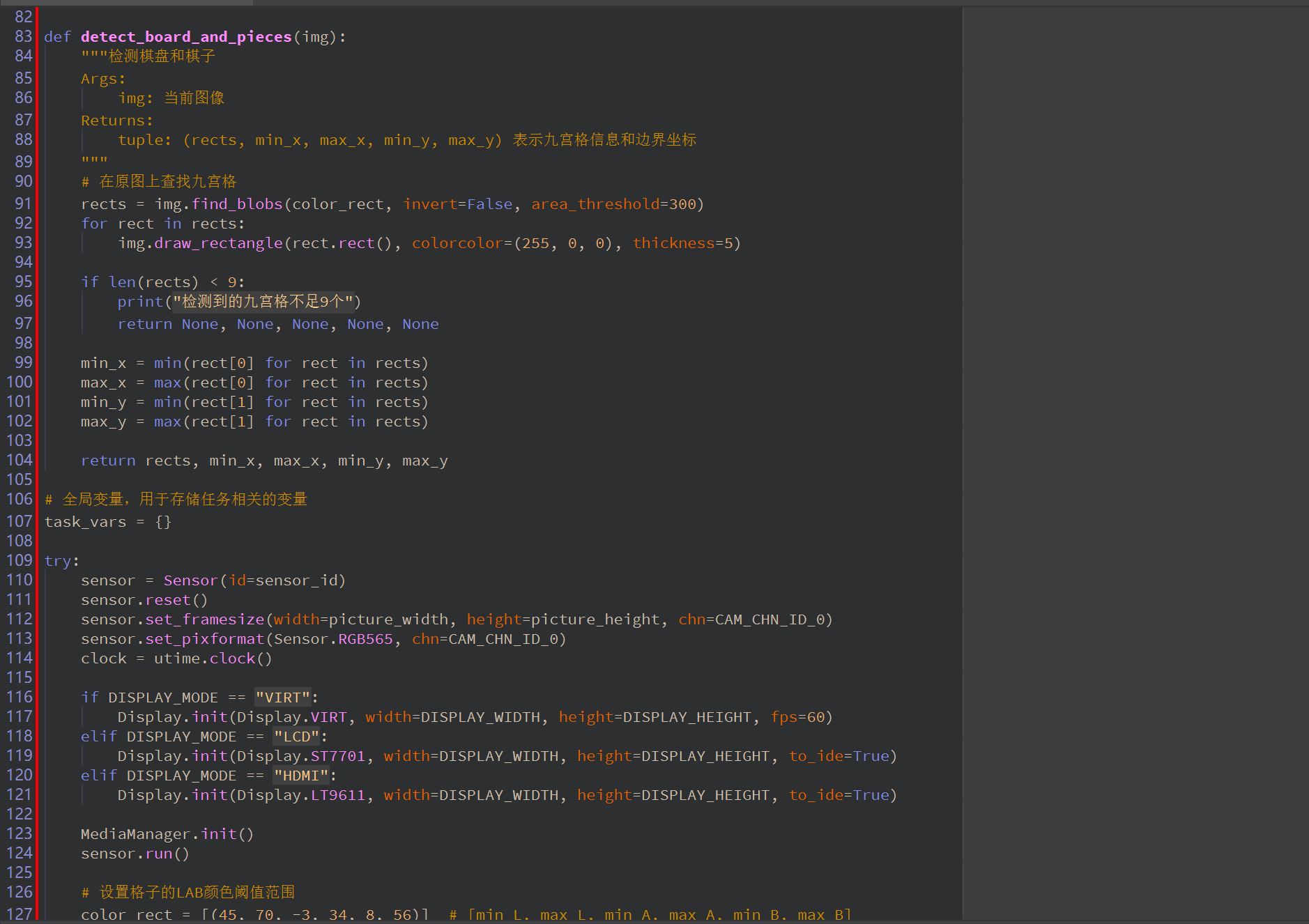

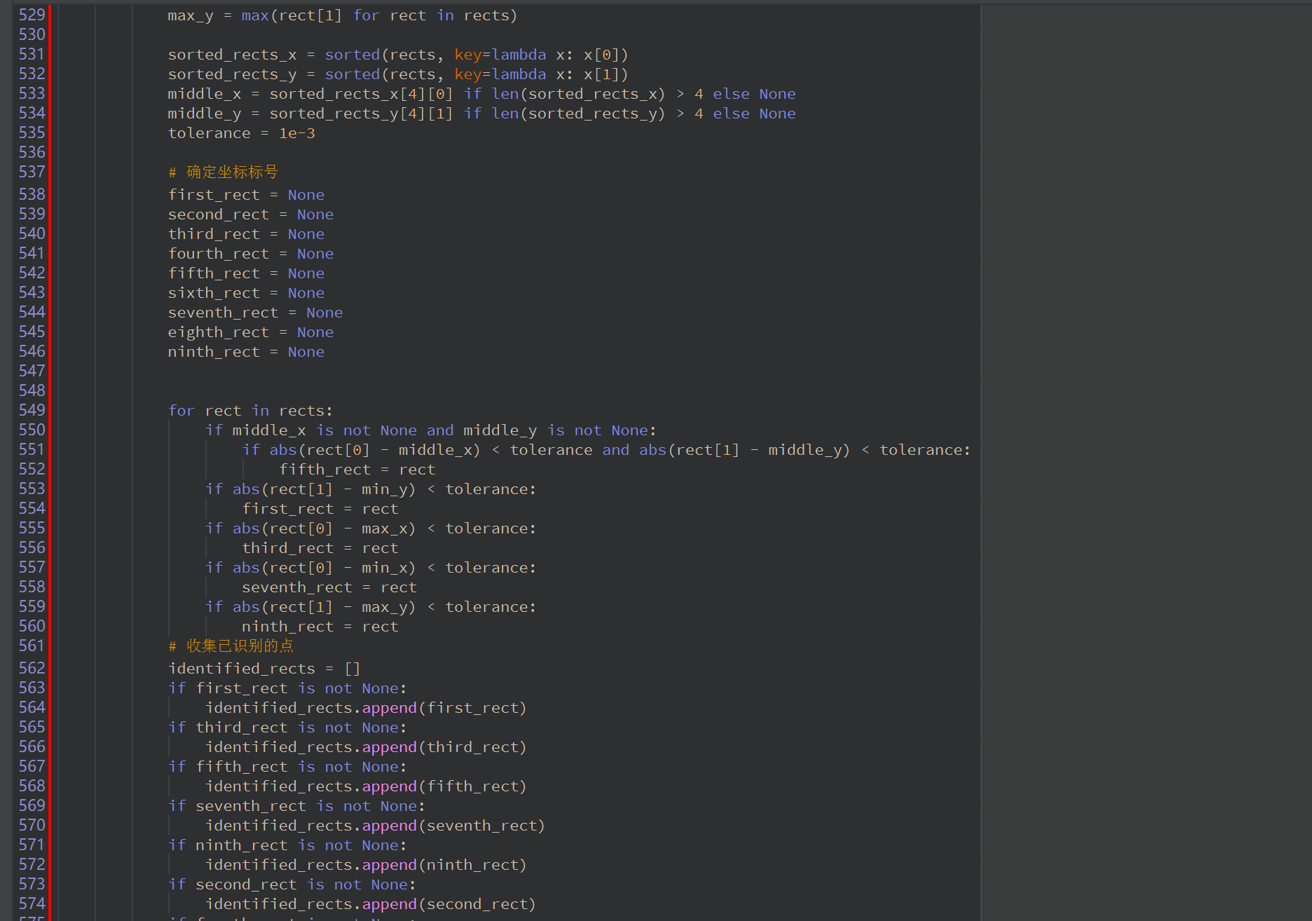

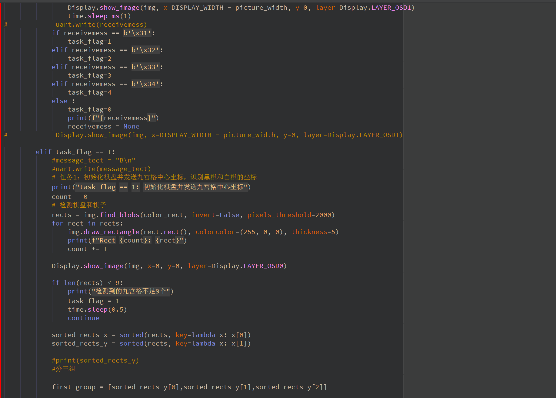

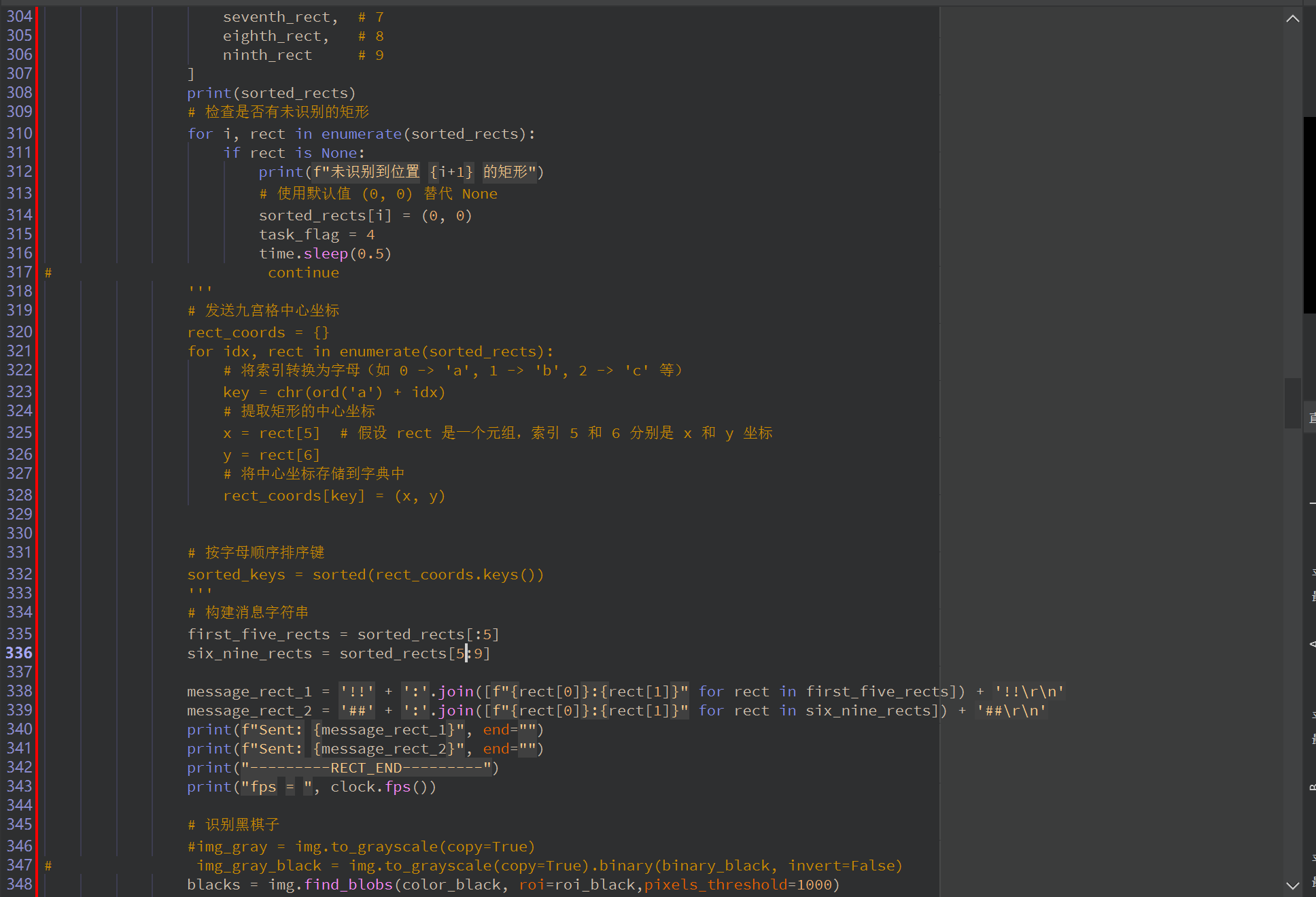

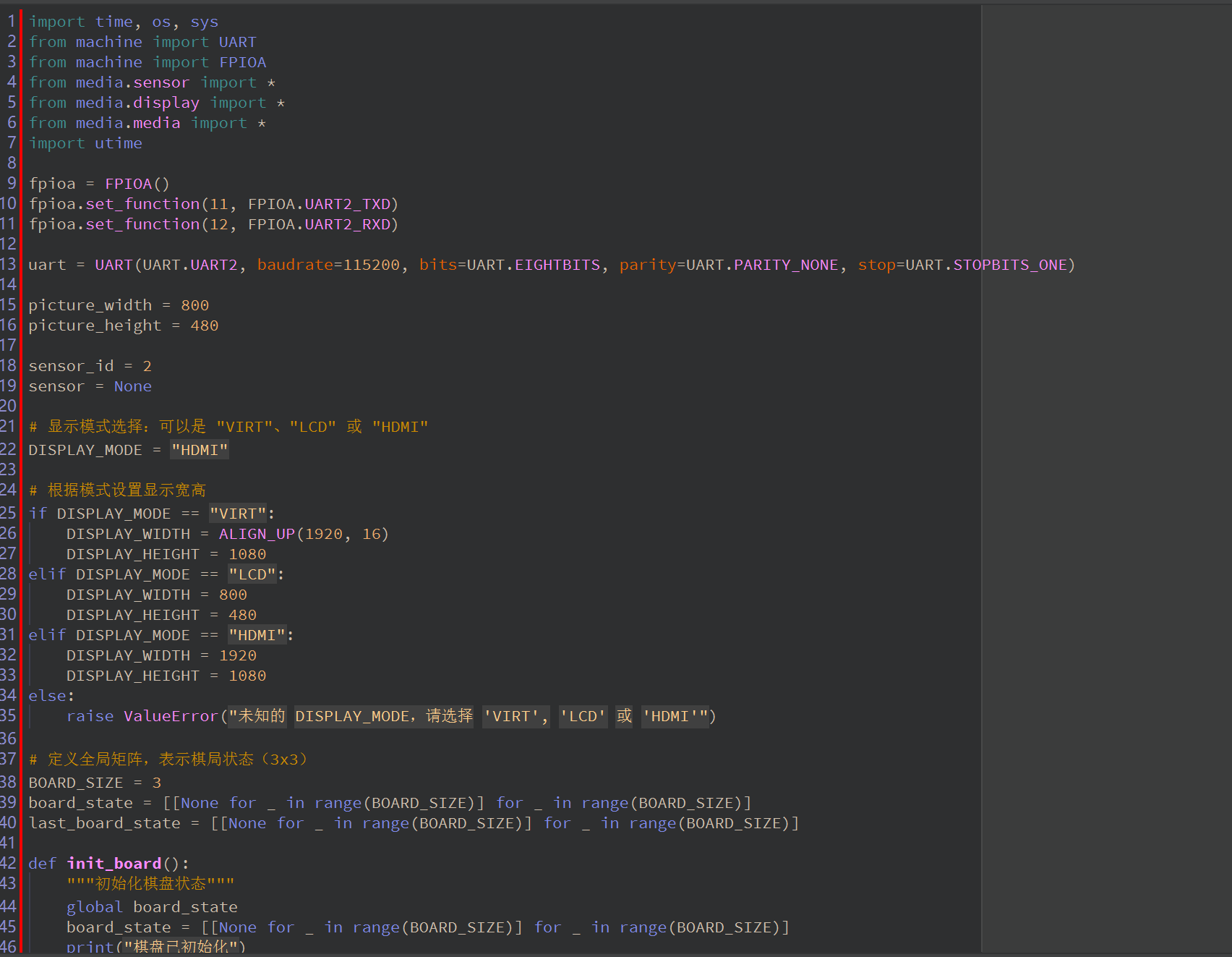

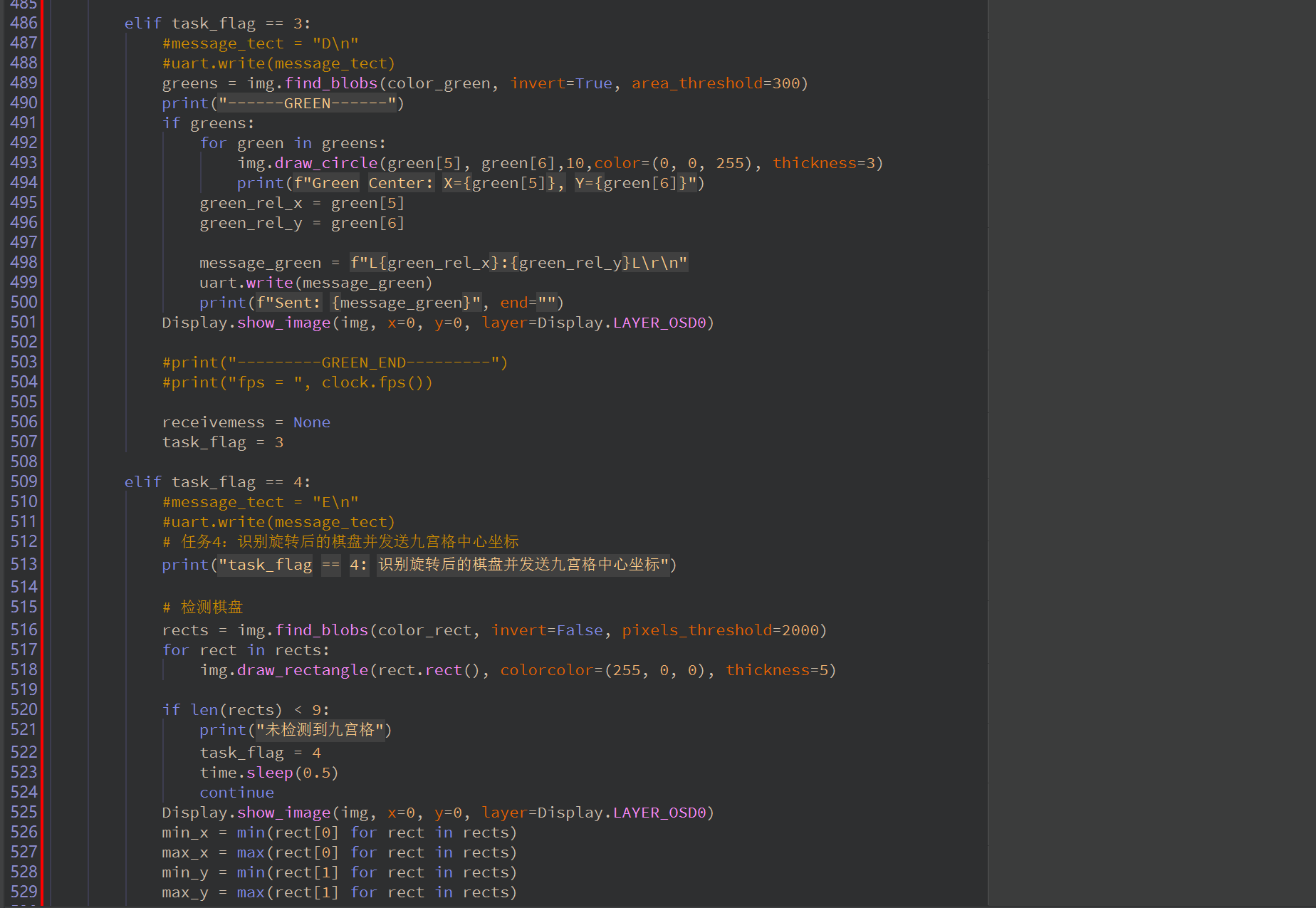

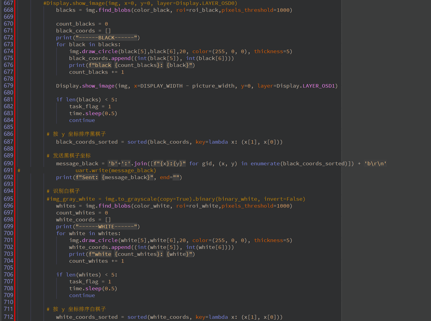

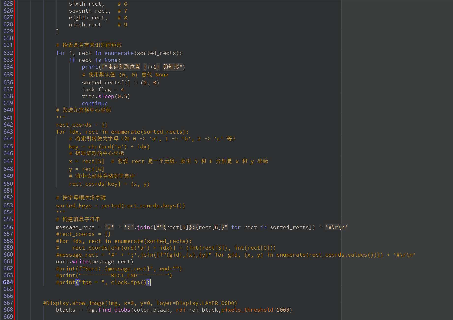

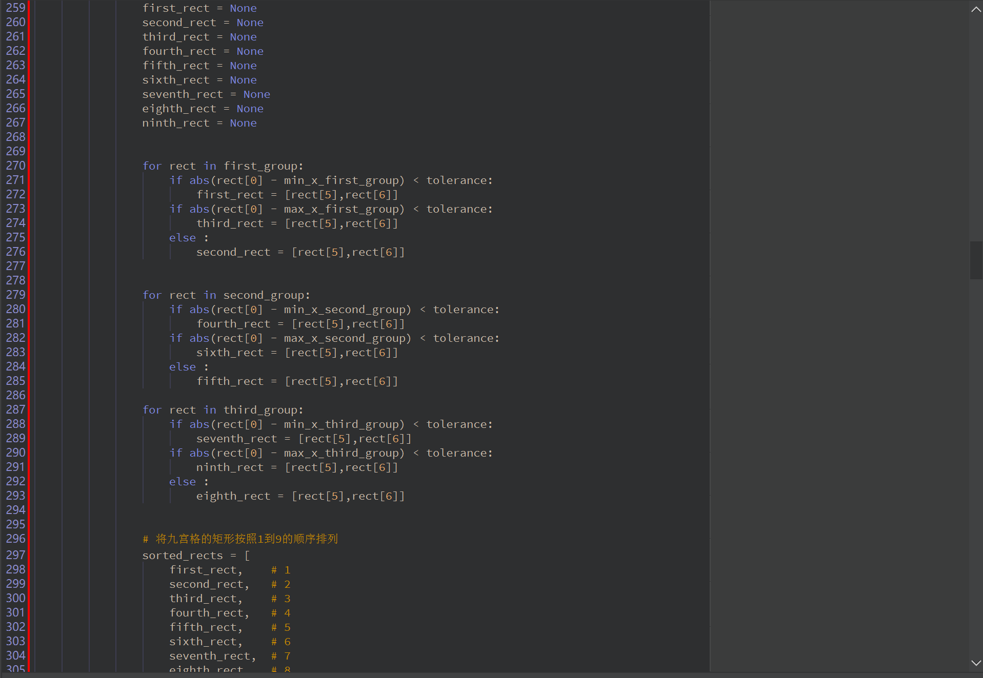

将代码文件保存后脱机运行不起来,其他文件可以,不脱机可正常运行
能正常脱机使用
image.pngimage.pngimage.pngimage.pngimage.pngimage.pngimage.pngimage.pngimage.pngimage.pngimage.pngimage.pngimage.pngimage.pngimage.pngimage.pngimage.png
你好,方便上传一下代码吗?可以用markdown的代码块。
已经在回答中上传
import time, os, sys
from machine import UART
from machine import FPIOA
from media.sensor import *
from media.display import *
from media.media import *
import utime
from machine import Pin
fpioa = FPIOA()
fpioa.set_function(11, FPIOA.UART2_TXD)
fpioa.set_function(12, FPIOA.UART2_RXD)
fpioa.set_function(52, FPIOA.GPIO52)
uart = UART(UART.UART2, baudrate=115200, bits=UART.EIGHTBITS, parity=UART.PARITY_NONE, stop=UART.STOPBITS_ONE)
picture_width = 800
picture_height = 480
sensor_id = 2
sensor = None
# 显示模式选择:可以是 "VIRT"、"LCD" 或 "HDMI"
DISPLAY_MODE = "HDMI"
# 根据模式设置显示宽高
if DISPLAY_MODE == "VIRT":
    DISPLAY_HEIGHT = 1080
elif DISPLAY_MODE == "LCD":
    DISPLAY_WIDTH = 800
    DISPLAY_HEIGHT = 480
elif DISPLAY_MODE == "HDMI":
    DISPLAY_WIDTH = 1920
    raise ValueError("未知的 DISPLAY_MODE,请选择 'VIRT', 'LCD' 或 'HDMI'")
# 定义全局矩阵,表示棋局状态(3x3)
BOARD_SIZE = 3
board_state = [[None for _ in range(BOARD_SIZE)] for _ in range(BOARD_SIZE)]
last_board_state = [[None for _ in range(BOARD_SIZE)] for _ in range(BOARD_SIZE)]
def init_board():
    """初始化棋盘状态"""
    global board_state
    print("棋盘已初始化")

                first_rect = None
                second_rect = None
                third_rect = None
                fourth_rect = None
                fifth_rect = None
                sixth_rect = None
                seventh_rect = None
                eighth_rect = None
                ninth_rect = None
                for rect in first_group:
                    if abs(rect[0] - min_x_first_group) < tolerance:
                        first_rect = [rect[5],rect[6]]
                    if abs(rect[0] - max_x_first_group) < tolerance:
                        third_rect = [rect[5],rect[6]]
                    else :
                        second_rect = [rect[5],rect[6]]
                for rect in second_group:
                    if abs(rect[0] - min_x_second_group) < tolerance:
                        fourth_rect = [rect[5],rect[6]]
                    if abs(rect[0] - max_x_second_group) < tolerance:
                        sixth_rect = [rect[5],rect[6]]
                    else :
                        fifth_rect = [rect[5],rect[6]]
                for rect in third_group:
                    if abs(rect[0] - min_x_third_group) < tolerance:
                        seventh_rect = [rect[5],rect[6]]
                    if abs(rect[0] - max_x_third_group) < tolerance:
                        ninth_rect = [rect[5],rect[6]]
                    else :
                        eighth_rect = [rect[5],rect[6]]
                # 将九宫格的矩形按照1到9的顺序排列
                sorted_rects = [
                    first_rect,    # 1
                    second_rect,   # 2
                    third_rect,    # 3
                    fourth_rect,   # 4
                    fifth_rect,    # 5
                    sixth_rect,    # 6
                    seventh_rect,  # 7
                    eighth_rect,   # 8
                    ninth_rect     # 9
                print(sorted_rects)
                # 检查是否有未识别的矩形
                for i, rect in enumerate(sorted_rects):
                    if rect is None:
                        print(f"未识别到位置 {i+1} 的矩形")
                        # 使用默认值 (0, 0) 替代 None
                        sorted_rects[i] = (0, 0)
                        task_flag = 4
                        time.sleep(0.5)
#                        continue
                # 发送九宫格中心坐标
                rect_coords = {}
                for idx, rect in enumerate(sorted_rects):
                    # 将索引转换为字母(如 0 -> 'a', 1 -> 'b', 2 -> 'c' 等)
                    key = chr(ord('a') + idx)
                    # 提取矩形的中心坐标
                    x = rect[5]  # 假设 rect 是一个元组,索引 5 和 6 分别是 x 和 y 坐标
                    y = rect[6]
                    # 将中心坐标存储到字典中
                    rect_coords[key] = (x, y)
                # 按字母顺序排序键
                sorted_keys = sorted(rect_coords.keys())
                # 构建消息字符串
                message_rect = '#' + ':'.join([f"{rect[0]}:{rect[1]}" for rect in sorted_rects]) + '#\r\n'
                print(f"Sent: {message_rect}", end="")
                print("---------RECT_END---------")
                print("fps = ", clock.fps())
                # 识别黑棋子
                #img_gray = img.to_grayscale(copy=True)
#                img_gray_black = img.to_grayscale(copy=True).binary(binary_black, invert=False)
                blacks = img.find_blobs(color_black, roi=roi_black,pixels_threshold=1000)
                count_blacks = 0
                black_coords = []
                print("------BLACK------")
                for black in blacks:
#                    img.draw_circle(black[5],black[6],20, color=(255, 0, 0), thickness=5)
                    black_coords.append((int(black[5]), int(black[6])))
                    print(f"black {count_blacks}: {black}")
                    count_blacks += 1
                #Display.show_image(img, x=DISPLAY_WIDTH - picture_width, y=0, layer=Display.LAYER_OSD1)
                if len(blacks) < 5:
                    task_flag = 1
                    time.sleep(0.5)
                    continue
                # 按 y 坐标排序黑棋子
                black_coords_sorted = sorted(black_coords, key=lambda x: (x[1], x[0]))
                # 发送黑棋子坐标
                message_black = 'b'+':'.join([f"{x}:{y}" for gid, (x, y) in enumerate(black_coords_sorted)]) + 'b\r\n'
#                uart.write(message_black)
                print(f"Sent: {message_black}", end="")
                # 识别白棋子
                #img_gray_white = img.to_grayscale(copy=True).binary(binary_white, invert=False)
                whites = img.find_blobs(color_white, roi=roi_white, pixels_threshold=1000)
                count_whites = 0
                white_coords = []
                print("------WHITE------")

        elif task_flag == 3:
            #message_tect = "D\n"
            #uart.write(message_tect)
            greens = img.find_blobs(color_green, invert=True, area_threshold=300)
            print("------GREEN------")
            if greens:
                for green in greens:
                    img.draw_circle(green[5], green[6],10,color=(0, 0, 255), thickness=3)
                    print(f"Green Center: X={green[5]}, Y={green[6]}")
                green_rel_x = green[5]
                green_rel_y = green[6]
                message_green = f"L{green_rel_x}:{green_rel_y}L\r\n"
                uart.write(message_green)
                print(f"Sent: {message_green}", end="")
            Display.show_image(img, x=0, y=0, layer=Display.LAYER_OSD0)
            #print("---------GREEN_END---------")
            #print("fps = ", clock.fps())
            receivemess = None
            task_flag = 3
        elif task_flag == 4:
            #message_tect = "E\n"
            # 任务4:识别旋转后的棋盘并发送九宫格中心坐标
            print("task_flag == 4: 识别旋转后的棋盘并发送九宫格中心坐标")
            # 检测棋盘
            rects = img.find_blobs(color_rect, invert=False, pixels_threshold=2000)
            for rect in rects:
                img.draw_rectangle(rect.rect(), colorcolor=(255, 0, 0), thickness=5)
            if len(rects) < 9:
                print("未检测到九宫格")
                task_flag = 4
                time.sleep(0.5)
                continue
            min_x = min(rect[0] for rect in rects)
            max_x = max(rect[0] for rect in rects)
            min_y = min(rect[1] for rect in rects)
            max_y = max(rect[1] for rect in rects)
            sorted_rects_x = sorted(rects, key=lambda x: x[0])
            sorted_rects_y = sorted(rects, key=lambda x: x[1])
            middle_x = sorted_rects_x[4][0] if len(sorted_rects_x) > 4 else None
            middle_y = sorted_rects_y[4][1] if len(sorted_rects_y) > 4 else None
            tolerance = 1e-3
            # 确定坐标标号
            first_rect = None

            # 将九宫格的矩形按照1到9的顺序排列
            sorted_rects = [
                first_rect,    # 1
                second_rect,   # 2
                third_rect,    # 3
                fourth_rect,   # 4
                fifth_rect,    # 5
                sixth_rect,    # 6
                seventh_rect,  # 7
                eighth_rect,   # 8
                ninth_rect     # 9
            # 检查是否有未识别的矩形
                if rect is None:
                    task_flag = 4
                    time.sleep(0.5)
                    continue
            # 发送九宫格中心坐标
            rect_coords = {}
                # 提取矩形的中心坐标
                y = rect[6]
                # 将中心坐标存储到字典中
            # 按字母顺序排序键
            # 构建消息字符串
            message_rect = '#' + ':'.join([f"{rect[5]}:{rect[6]}" for rect in sorted_rects]) + '#\r\n'
            #rect_coords = {}
            #for idx, rect in enumerate(sorted_rects):
            #    rect_coords[chr(ord('a') + idx)] = (int(rect[5]), int(rect[6]))
            #message_rect = '#' + ';'.join([f"{gid},{x},{y}" for gid, (x, y) in enumerate(rect_coords.values())]) + '#\r\n'
            uart.write(message_rect)
            #print(f"Sent: {message_rect}", end="")
            #print("---------RECT_END---------")
        #Display.show_image(img, x=0, y=0, layer=Display.LAYER_OSD0)
            count_blacks = 0
            black_coords = []
                count_blacks += 1
            if len(blacks) < 5:
                task_flag = 1
                time.sleep(0.5)
                continue
         # 按 y 坐标排序黑棋子
         # 发送黑棋子坐标
         # 识别白棋子
            whites = img.find_blobs(color_white, roi=roi_white,pixels_threshold=1000)
            count_whites = 0
            white_coords = []
            for white in whites:
                img.draw_circle(white[5],white[6],20, color=(255, 0, 0), thickness=5)
                white_coords.append((int(white[5]), int(white[6])))
                print(f"white {count_whites}: {white}")
                count_whites += 1
            if len(whites) < 5:
                task_flag = 1
                time.sleep(0.5)
                continue
         # 按 y 坐标排序白棋子
            white_coords_sorted = sorted(white_coords, key=lambda x: (x[1], x[0]))
         # 发送白棋子坐标
            message_white = 'w'+':'.join([f"{x}:{y}" for gid, (x, y) in enumerate(white_coords_sorted)]) + 'w\r\n'
