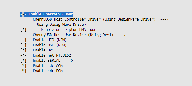

  • USB HOST的menuconfig配置如下 ↓

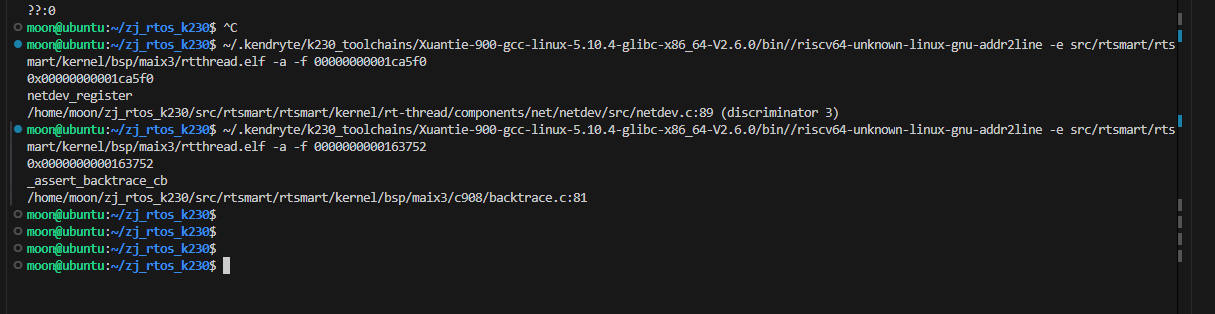

riscv64-unknown-linux-musl-addr2line -e rtthread.elf -a -f 00000000001ca5f0
[E/DBG] User Fault, killing thread: usbh_hub0
(rt_object_get_type((rt_object_t)thread) == RT_Object_Class_Thread) assertion failed at function:rt_thread_control, line number:745
riscv64-unknown-linux-musl-addr2line -e rtthread.elf -a -f 0000000000163752
  • 以下是addr2line的结果
moon@ubuntu:~/zj_rtos_k230$ ^C
moon@ubuntu:~/zj_rtos_k230$ ~/.kendryte/k230_toolchains/Xuantie-900-gcc-linux-5.10.4-glibc-x86_64-V2.6.0/bin//riscv64-unknown-linux-gnu-addr2line -e src/rtsmart/rtsmart/kernel/bsp/maix3/rtthread.elf -a -f 00000000001ca5f0
0x00000000001ca5f0
netdev_register
/home/moon/zj_rtos_k230/src/rtsmart/rtsmart/kernel/rt-thread/components/net/netdev/src/netdev.c:89 (discriminator 3)
moon@ubuntu:~/zj_rtos_k230$ ~/.kendryte/k230_toolchains/Xuantie-900-gcc-linux-5.10.4-glibc-x86_64-V2.6.0/bin//riscv64-unknown-linux-gnu-addr2line -e src/rtsmart/rtsmart/kernel/bsp/maix3/rtthread.elf -a -f 0000000000163752
0x0000000000163752
_assert_backtrace_cb
/home/moon/zj_rtos_k230/src/rtsmart/rtsmart/kernel/bsp/maix3/c908/backtrace.c:81
