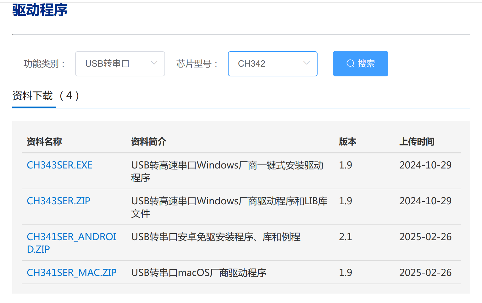

linux系统下 没有庐山派CH342驱动
Viewed 473
CH342没有linux下的驱动,目前插入庐山派以后,canmv-ide无法识别到开发板,(通过lsusb可以查看到开发板
Bus 003 Device 005: ID 29f1:0230 Canaan Creative Co., Ltd K230 USB Boot Device )
期待可以在ubuntu系统下,canide可以正确识别到开发板

下载了CH343SER.ZIP,但是没有linux驱动.
之后又下载了https://github.com/WCHSoftGroup/ch343ser_linux.git,安装以后,依然不能正常连接.
sudo dmesg | grep ch34 [sudo] password for semikernel: [ 3.710513] ch343: loading out-of-tree module taints kernel. [ 3.710520] ch343: module verification failed: signature and/or required key missing - tainting kernel [ 3.710967] usbcore: registered new interface driver usb_ch343 [ 3.710969] ch343: USB serial driver for ch342/ch343/ch344/ch346/ch347/ch339/ch9101/ch9102/ch9103/ch9104/ch9143, etc. [ 3.710970] ch343: V1.9 On 2025.01

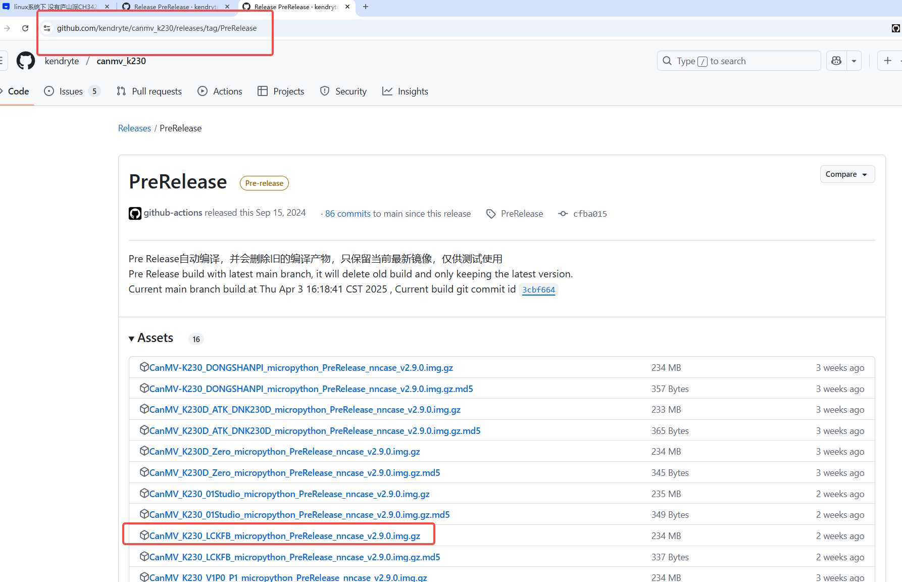

烧录的那个镜像?
CanMV 最新的 MicroPython LCKFB的
micropython 不需要ch343驱动,庐山派没有ch34x串口芯片,看打印是没有烧录成功,如果看串口信息的话,需要接串口小板。
请换个烧录工具重新烧录下镜像。 你的镜像是从哪里下载的?有链接吗?
链接是 https://kendryte-download.canaan-creative.com/developer/k230/CanMV-v1.2.2/CanMV-K230_LCKFB_micropython_v1.2.2-0-g4b8cae1_nncase_v2.9.0.img.gz 使用rufus和 BalenaEtcher烧录,均不能正确识别
