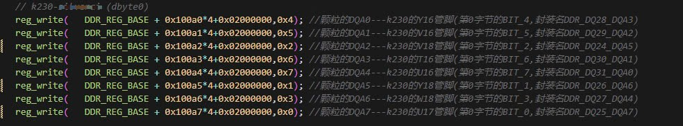

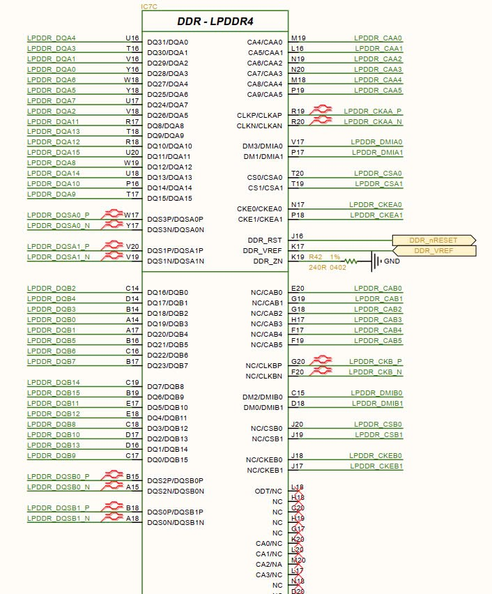

  • I edit PQ pin Lpddr4 (I edited lpddr4_init_32_swap_2667.c and rebuild u-boot).

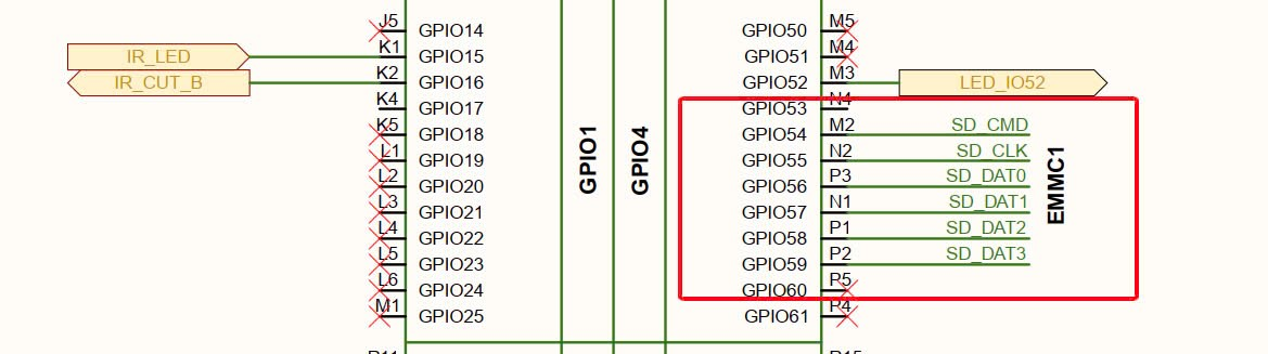

  • SDCard > MMC1
When i config boot from MMC1 (SD card , BOOT0=1 BOOT1=1), i get error boot:

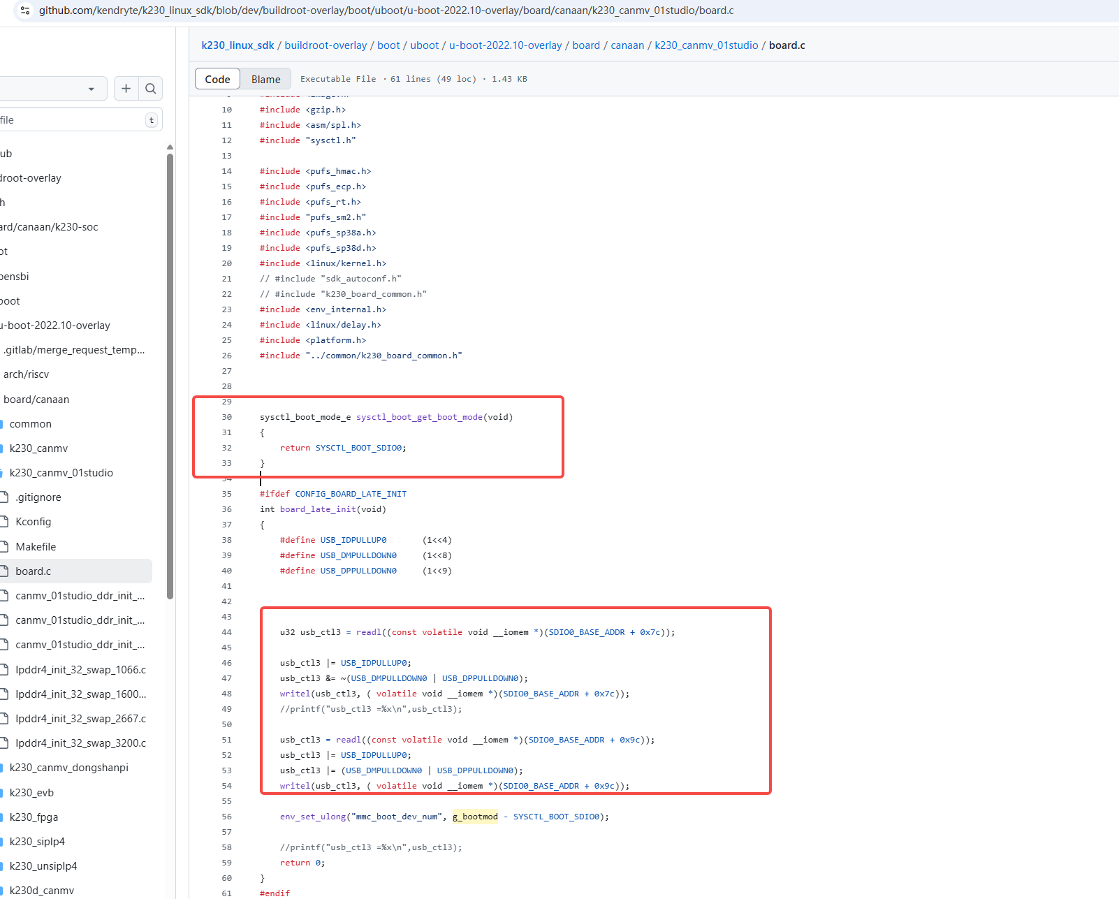

Comment out the code I marked in red,Because 01 board force boot from SDIO0.
I modify as same picture (marked in red).
make uboot-rebuild
make
reflash to SD card
But it still get log with error as same above.
Do I need to edit somewhere else?

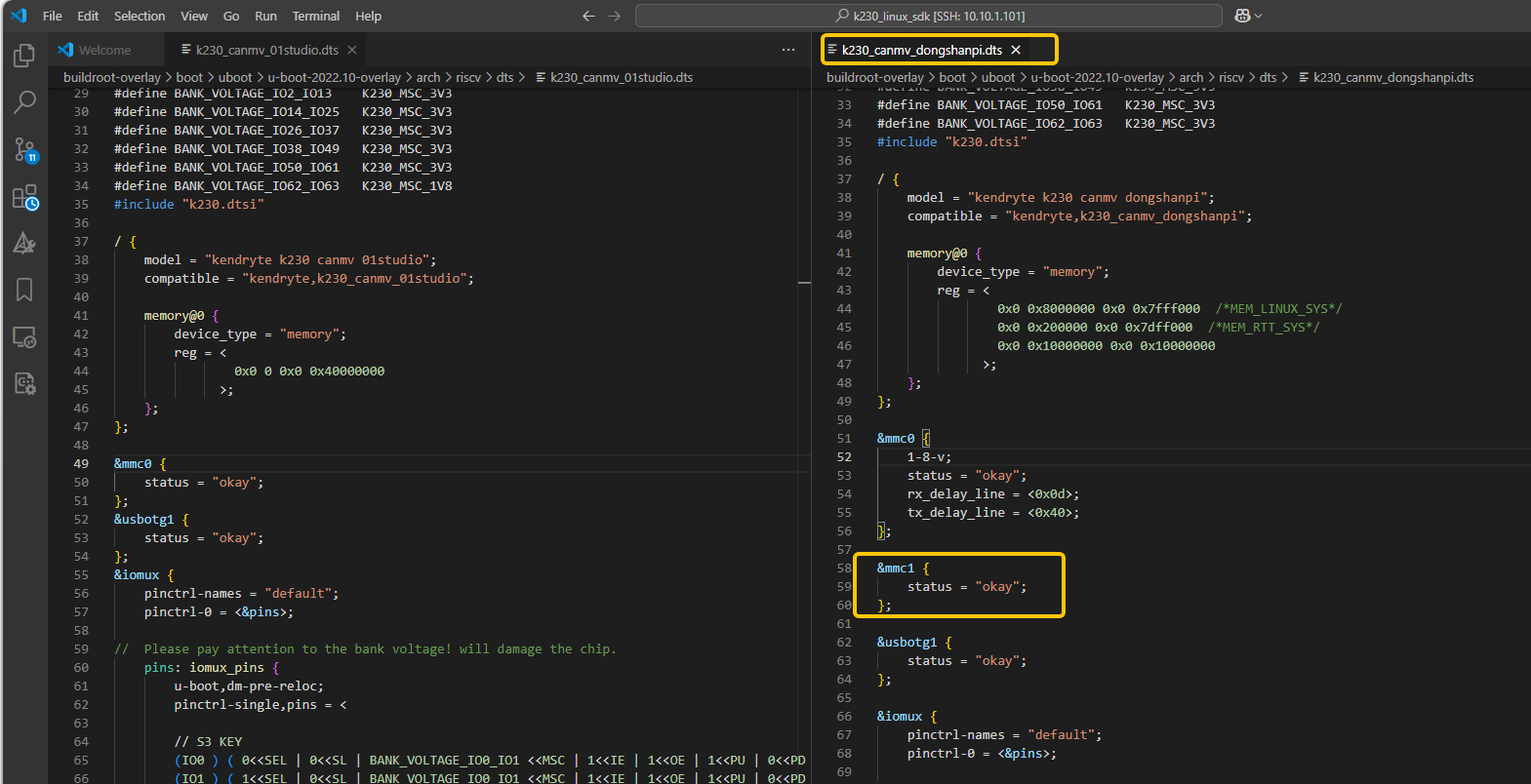

dts need add
&mmc1 {
status = "okay";
(dongshanpai support emmc and tf card,you can refer dongshanpai)

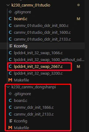

But, dongshanpai use lpddr3 and my board use lpddr4 2667.
So, how i can add lpddr4_init for dongshanpai?
It's better to refer to 01. For the device tree part, you can refer to Dongshanpi.
