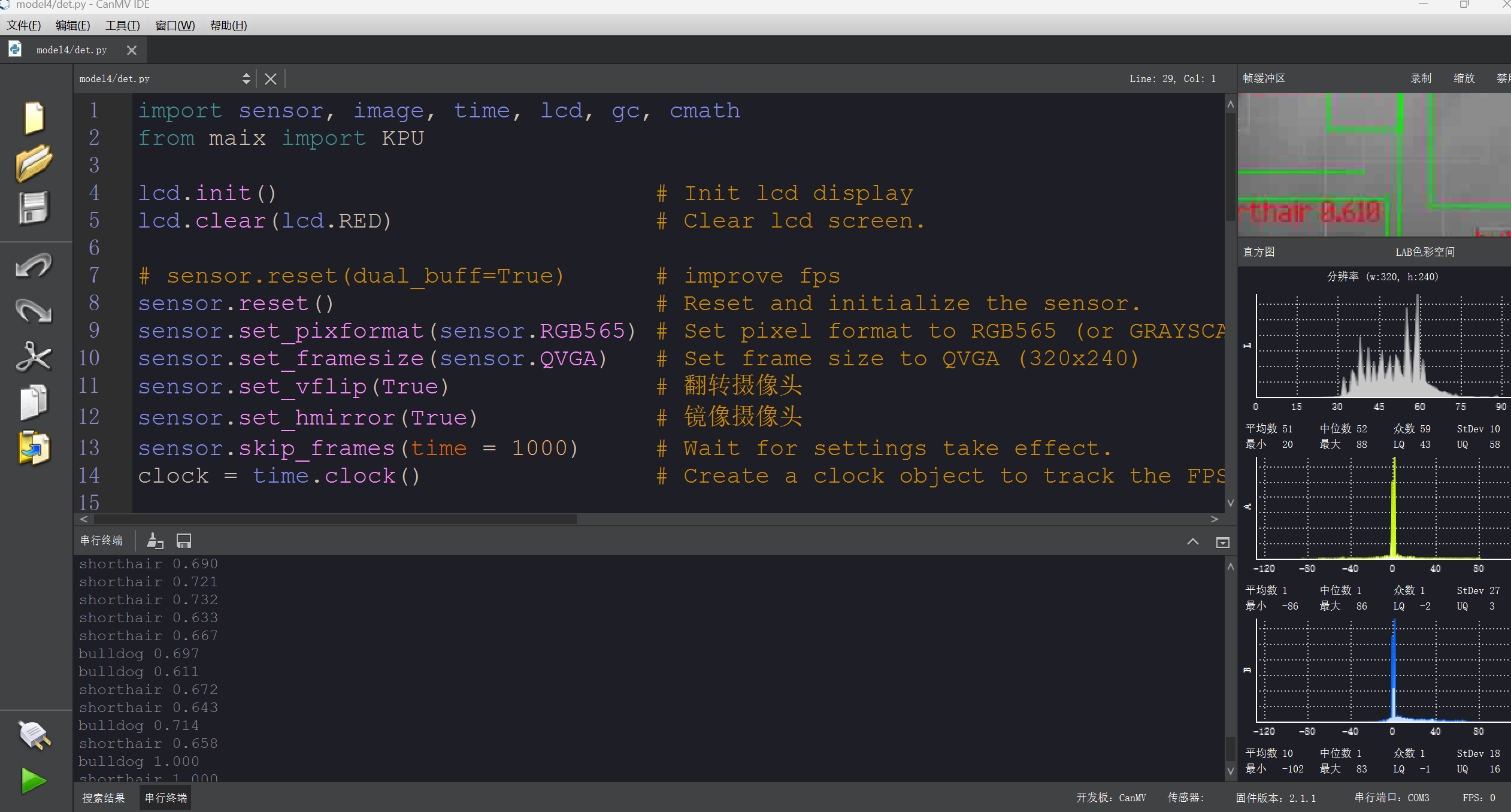

这是怎么回事
Viewed 228
v2.1.1
这是det_result
import sensor, image, time, lcd, gc, cmath
from maix import KPU
lcd.init()                          # Init lcd display
lcd.clear(lcd.RED)                  # Clear lcd screen.
# sensor.reset(dual_buff=True)      # improve fps
sensor.reset()                      # Reset and initialize the sensor.
sensor.set_pixformat(sensor.RGB565) # Set pixel format to RGB565 (or GRAYSCALE)
sensor.set_framesize(sensor.QVGA)   # Set frame size to QVGA (320x240)
sensor.set_vflip(True)              # 翻转摄像头
sensor.set_hmirror(True)            # 镜像摄像头
sensor.skip_frames(time = 1000)     # Wait for settings take effect.
clock = time.clock()                # Create a clock object to track the FPS.
print("ready load model")
labels = ["1", "2","3"]#类名称,按照label.tx![](/uploads/post/5sTjFRzmxeA.jpg)t顺序填写
anchor = (4.21, 4.65, 5.46, 5.51, 6.77, 5.18, 6.04, 6.34, 5.59, 7.12, 6.65, 6.65, 7.30, 6.24, 8.92, 5.83, 8.50, 7.04) # anchors,使用anchor.txt中第二行的值
kpu = KPU()
# 从sd或flash加载模型
kpu.load_kmodel('/sd/det.kmodel')
#kpu.load_kmodel(0x300000, 584744)
kpu.init_yolo2(anchor, anchor_num=(int)(len(anchor)/2), img_w=320, img_h=240, net_w=320 , net_h=240 ,layer_w=10 ,layer_h=8, threshold=0.6, nms_value=0.3, classes=len(labels))
while(True):
    img = sensor.snapshot()
    kpu.run_with_output(img)
    dect = kpu.regionlayer_yolo2()
    fps = clock.fps()
    if len(dect) > 0:
        for l in dect :
            a = img.draw_rectangle(l[0],l[1],l[2],l[3],color=(0,255,0))
            info = "%s %.3f" % (labels[l[4]], l[5])
            a = img.draw_string(l[0],l[1],info,color=(255,0,0),scale=2.0)
            print(info)
            del info
    a = img.draw_string(0, 0, "%2.1ffps" %(fps),color=(0,60,255),scale=2.0)
    lcd.display(img)
代码改一下,210的脚本不是拿过来就能用的,需要你自己改一下labels
改了,还是乱识别T_T
好了好了原来是没改anchor数组

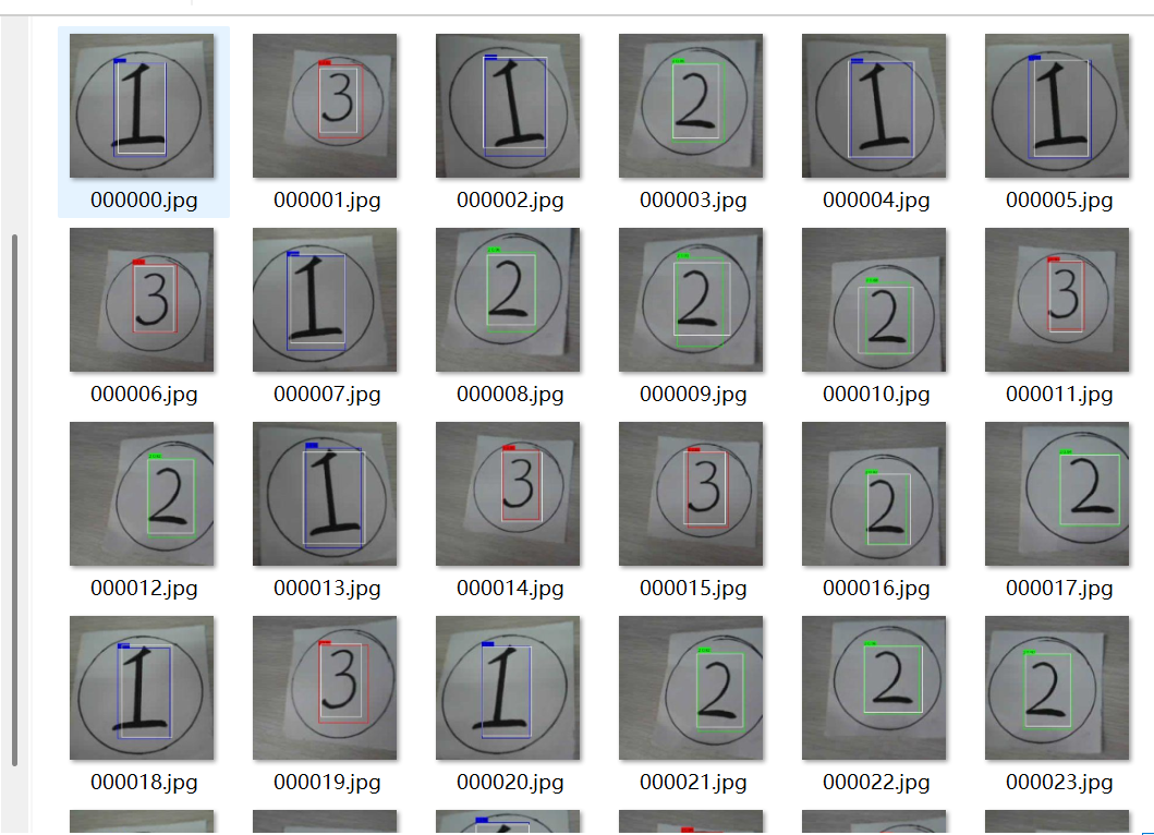

图片检测,每一步都做了,三标签每个七十几图T_T运行的时候乱出框T_TT_TT_TT_T
