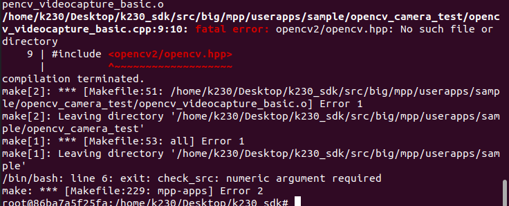

请问编译opencv_camera_test找不到opencv.hpp怎么解决?
Viewed 104
2.在k230_sdk目录下进入docker环境后使用make mpp-apps编译
期待得到opencv_camera_test.elf文件
创乐博k230V3.0,sdk版本1.9

CXX /home/k230/Desktop/k230_sdk/src/big/mpp/userapps/sample/opencv_camera_test/opencv_videocapture_basic.o
/home/k230/Desktop/k230_sdk/src/big/mpp/userapps/sample/opencv_camera_test/opencv_videocapture_basic.cpp:9:10: fatal error: opencv2/opencv.hpp: No such file or directory
9 | #include <opencv2/opencv.hpp>
compilation terminated.
make[2]: *** [Makefile:51: /home/k230/Desktop/k230_sdk/src/big/mpp/userapps/sample/opencv_camera_test/opencv_videocapture_basic.o] Error 1
make[2]: Leaving directory '/home/k230/Desktop/k230_sdk/src/big/mpp/userapps/sample/opencv_camera_test'
make[1]: *** [Makefile:10: all] Error 1
make[1]: Leaving directory '/home/k230/Desktop/k230_sdk/src/big/mpp/userapps/sample'
/bin/bash: line 6: exit: check_src: numeric argument required
make: *** [Makefile:229: mpp-apps] Error 2
您好,可以先完成固件编译过程,编译结束后在进行opencv应用的编译
