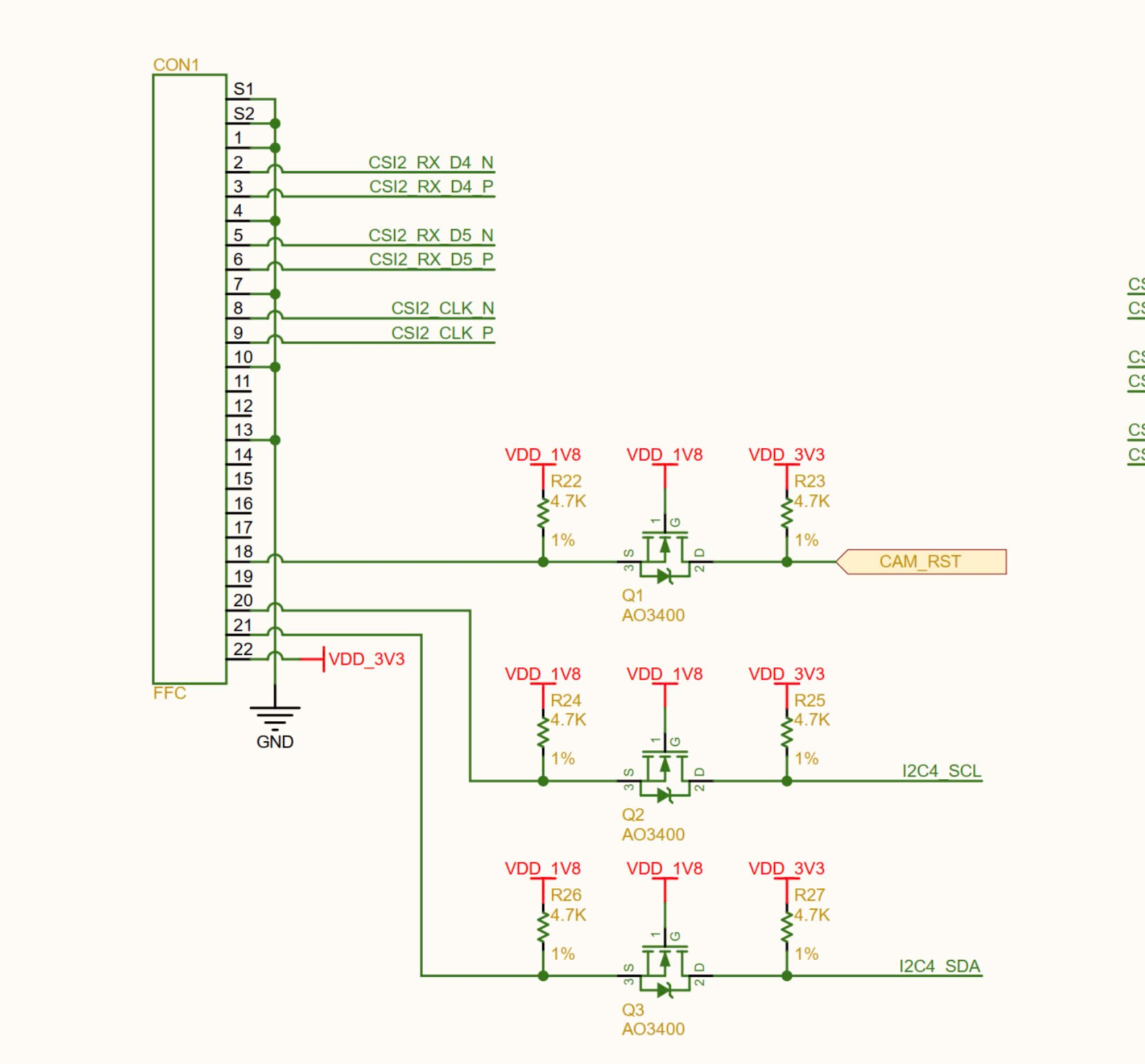

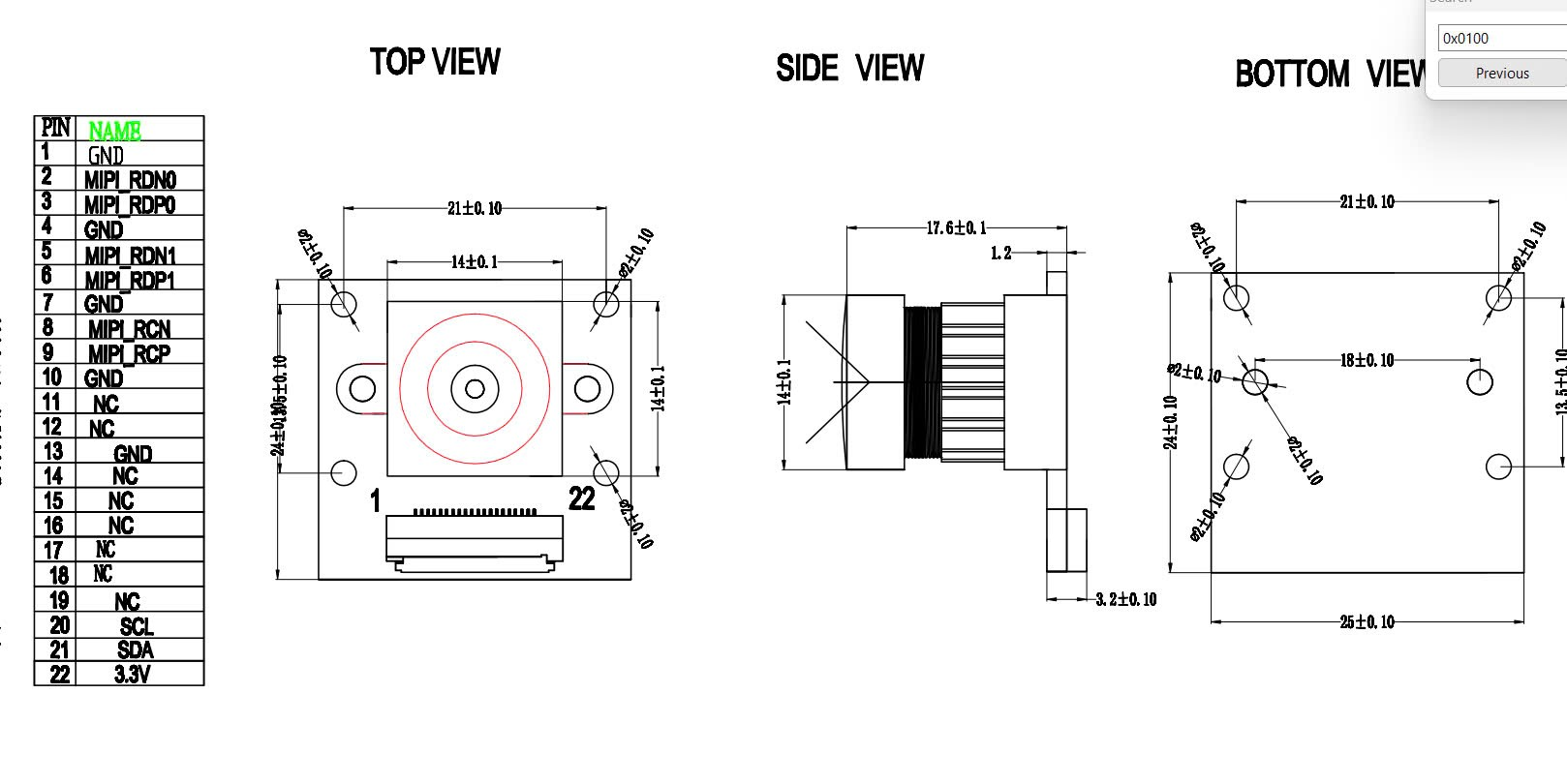

I develop a board (base K230 CanMV).
I connect Gc2093 with CSI-2. I detect GC2093 with "i2cdetect -y 0" I get -> 0x37.
But, i can't get frame from CSI

感觉看着isp没有错误的打印、这个我也看不出来,你先单独运行一下v4l2 的demo 看看有没有显示、或者打印什么错误,运行命令如下:
v4l2-drm -d 1 -w 1920 -h 1080
下边的打印看着像是vpu的打印,但是感觉buff 对列不咋对的样子,你还是先验证上边的命令是否正常
Finishing st[ 5068.527241] MVX session: 0000000075fc17fa Unable to signal EOS. Output buffer queue empty. (mvx_session.c:2813)
ream 0:0 without any data written to it.
thank you! My footprint data is wrong. I fix it ok
