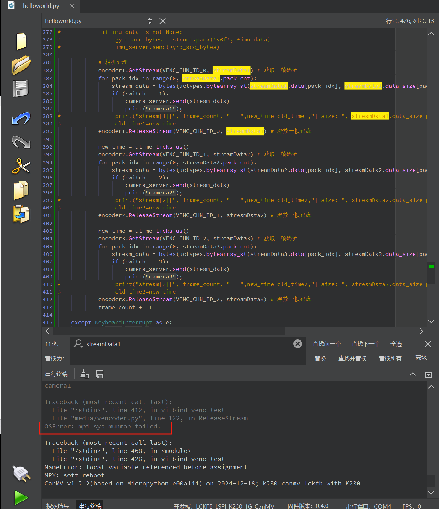

LCKFB开发板通过CanMV拿三路相机的数据并编码encoder3.ReleaseStream()函数报错
Viewed 109

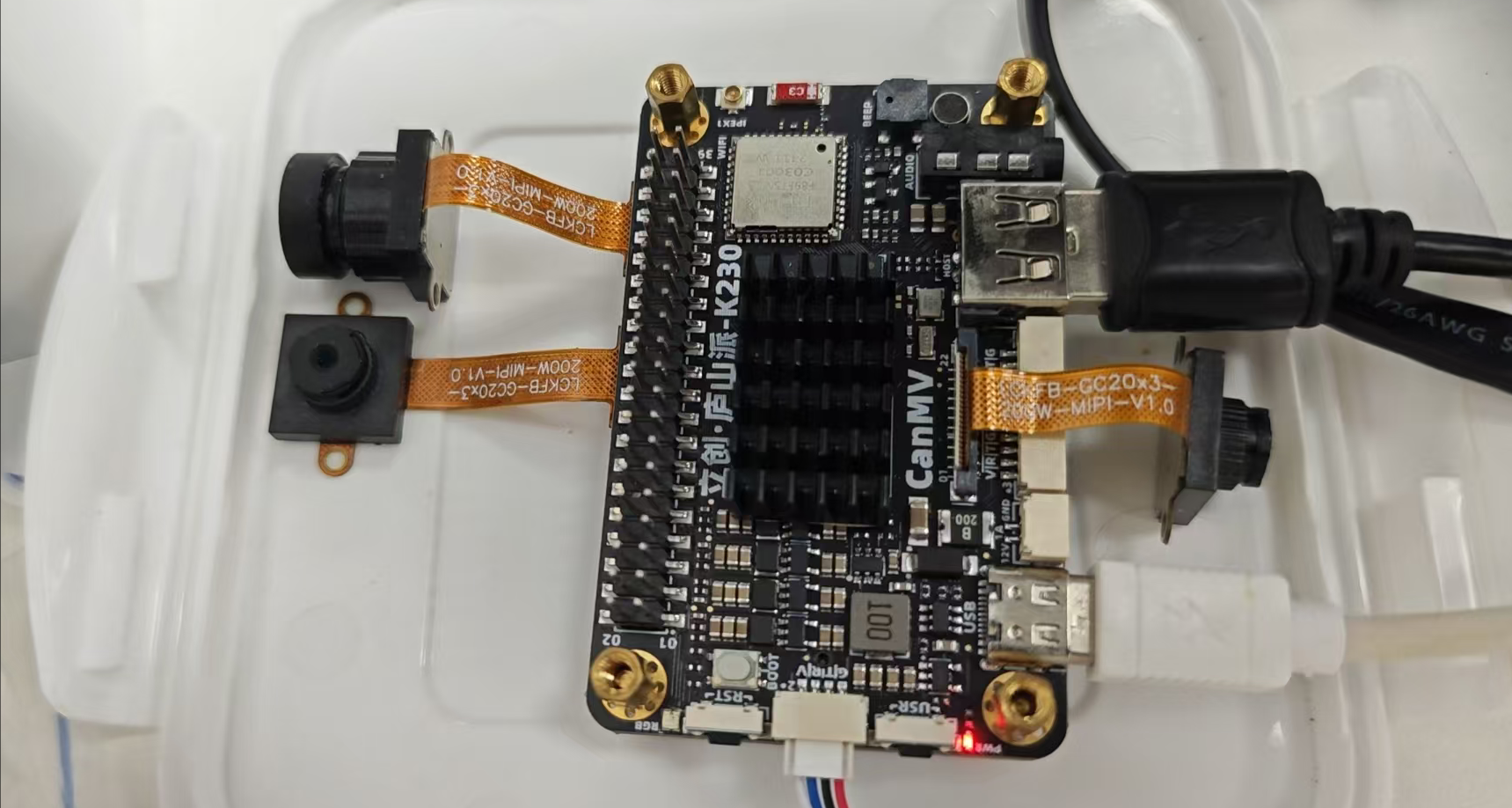

CanMV拿三路相机的数据并编码,硬件配置:
长时间稳定运行,但运行不久就报错:
麻烦提供一个完整的可以正常运行的代码,你得截图看不到前面做了什么操作。另外单线程处理多路推流效率不行,需改进。
好的,这个是我的使用的代码。另外单线程处理多路推流的问题我也同步改一下测试

                if (switch == 1):
                    camera_server.send(stream_data)
                    print("camera1");
#                print("stream[1][", frame_count, "] [",new_time-old_time1,"] size: ", streamData1.data_size[pack_idx], "stream type: ", streamData1.stream_type[pack_idx])
#                old_time1=new_time
            encoder1.ReleaseStream(VENC_CHN_ID_0, streamData1) # 释放一帧码流
            new_time = utime.ticks_us()
            encoder2.GetStream(VENC_CHN_ID_1, streamData2) # 获取一帧码流
            for pack_idx in range(0, streamData2.pack_cnt):
                stream_data = bytes(uctypes.bytearray_at(streamData2.data[pack_idx], streamData2.data_size[pack_idx]))
                if (switch == 2):
                    print("camera2");
#                print("stream[2][", frame_count, "] [",new_time-old_time2,"] size: ", streamData2.data_size[pack_idx], "stream type: ", streamData2.stream_type[pack_idx])
#                old_time2=new_time
            encoder2.ReleaseStream(VENC_CHN_ID_1, streamData2) # 释放一帧码流
            encoder3.GetStream(VENC_CHN_ID_2, streamData3) # 获取一帧码流
            for pack_idx in range(0, streamData3.pack_cnt):
                stream_data = bytes(uctypes.bytearray_at(streamData3.data[pack_idx], streamData3.data_size[pack_idx]))
                if (switch == 3):
                    print("camera3");
#                print("stream[3][", frame_count, "] [",new_time-old_time2,"] size: ", streamData3.data_size[pack_idx], "stream type: ", streamData3.stream_type[pack_idx])
            encoder3.ReleaseStream(VENC_CHN_ID_2, streamData3) # 释放一帧码流
            frame_count += 1
        print("user stop: ", e)
    except BaseException as e:
        import sys
        sys.print_exception(e)
