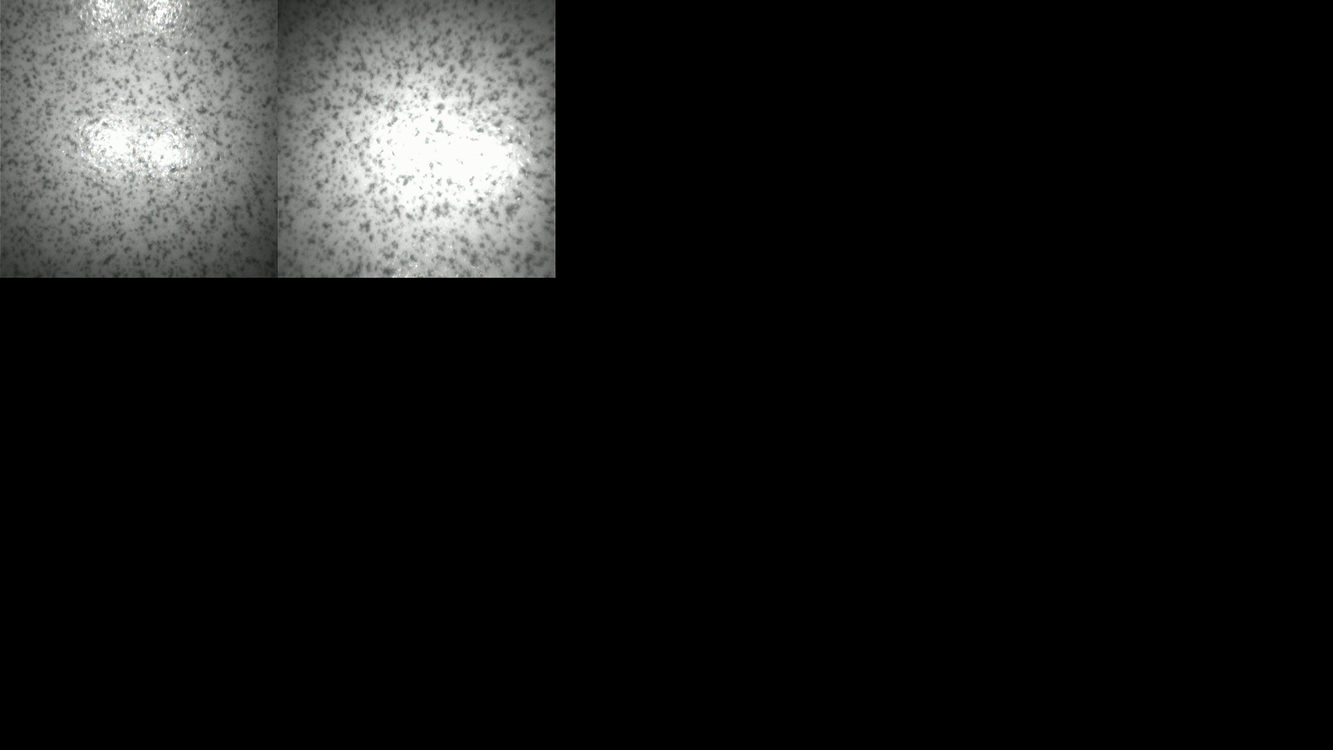

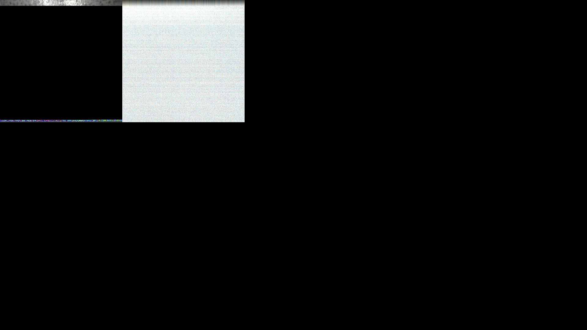

./sharefs/app/sample_vicap.elf -mode 1 -conn 1 -dev 0 -sensor 81 -chn 0 -ow 400 -oh 400 -dev 1 -sensor 82 -chn 0 -ow 400 -oh 400
I get two frozen frames, with some visual artifacts.

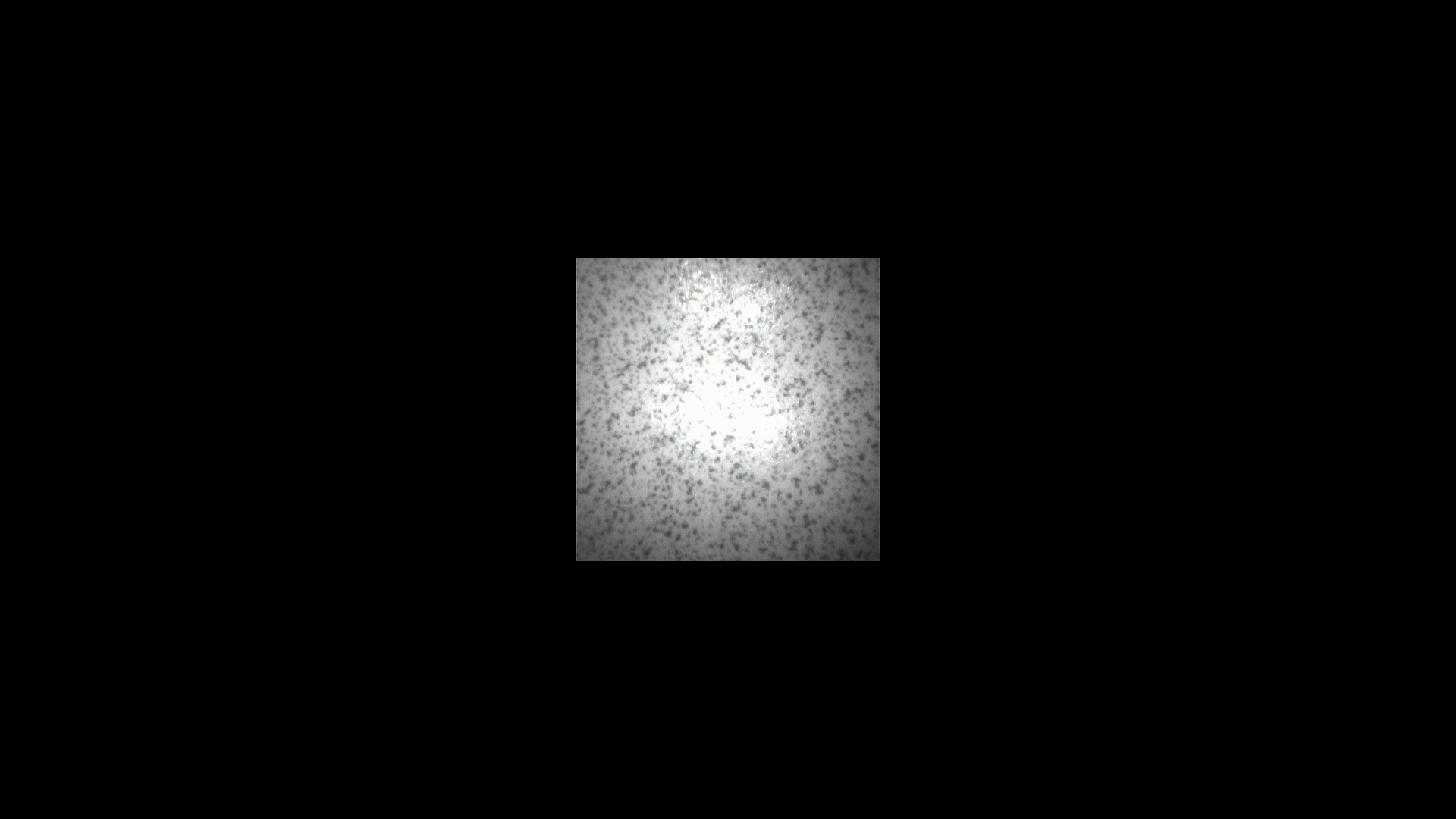

Here is the single camera view pointed at my table surface (it responds to motion fine):

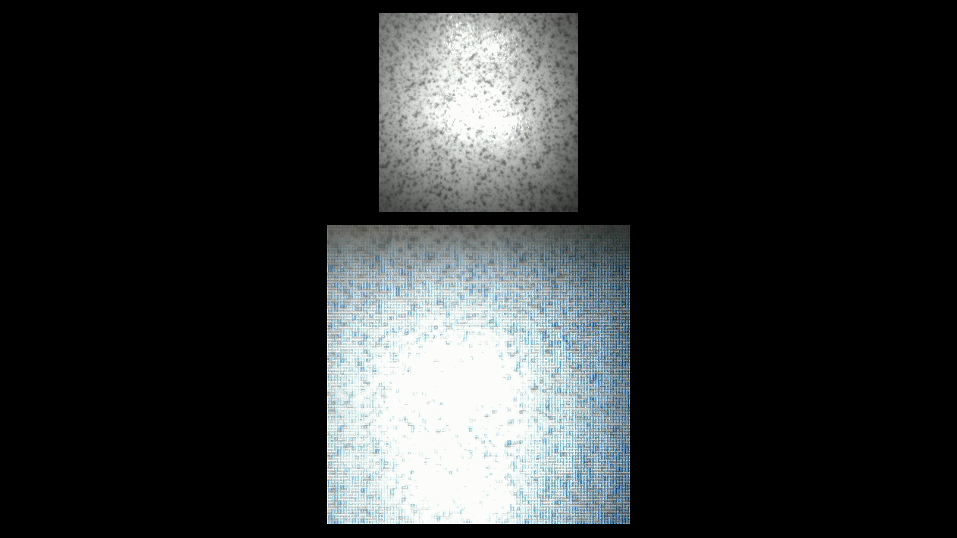

Next, here is dual camera normal and then also with a closeup of the second camera to show the pattern better (the screen immediately freezes and does not respond to motion, but sample_vicap is still responsive and I can press 'q' to quit):
I have been very carefully studying the datasheet for these cameras, and also researching the MIPI CSI protocol, and it seems that many SOCs have some limitations on the D-phy interface especially when running multiple cameras. I could not find any info about the K230 D-phy interface requirements, would you be able to share more details so I can make sure that the camera is configured to be compatible?
Also after enabling debug messages in the camera driver, I am noticing that at lower framerates the ISP is pulling maybe 4 or 5 frames instead of only one before freezing. This makes me wonder if maybe there is some clock configuration that is not correct for the SOC.

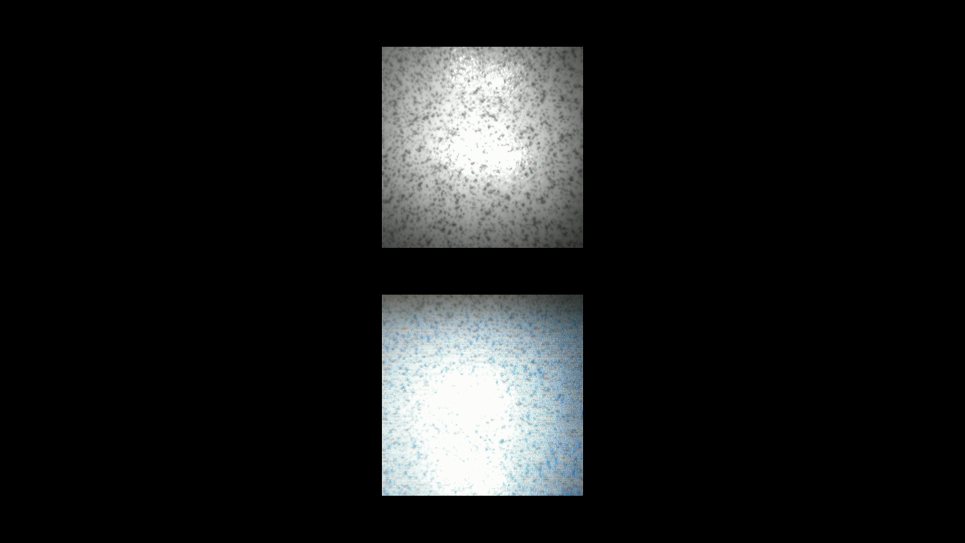

The cameras are configured for 400x400@120fps 10-bit raw mode, and the first time I run the program after power cycle I see the following result:
If I exit and run the program agian, I usually get two good frames, but they are still frozen:
