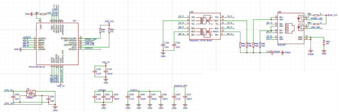

@wjx I attached schematic of ethernet part. can you please help me to debug the hardware issue?

We have made custom PCB board based on V3 design files. There is no change in USB & Ethernet peripherals. It is same as V3 design.
Can you please help me to debug the issue with our custom PCB?
Below I attached schematic of Ethernet part.

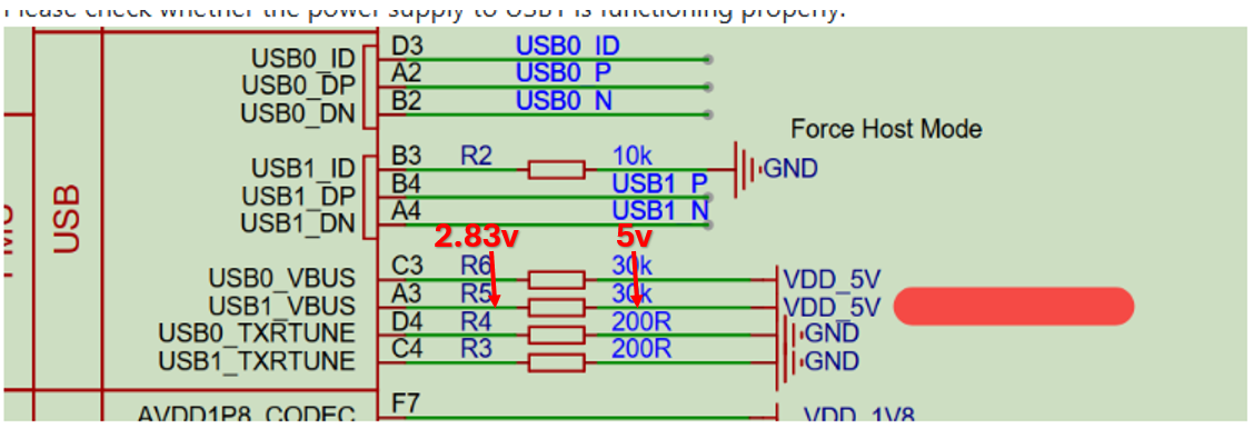

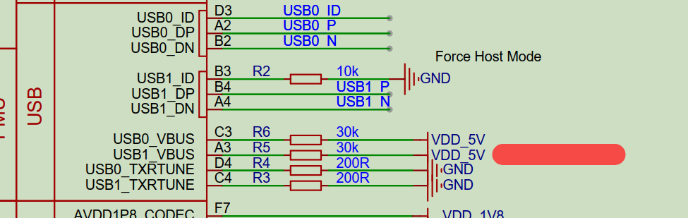

Please check whether the power supply to USB1 is functioning properly.
@wjx I checked the voltage. Please check my answer.
I checked voltage on USB1_VBUS. 5v on one side of 30k resistor and 2.83v on other side of resistor.
@wjx Can you please help!!

To ensure the RTL8152B USB-to-Ethernet chip is in working condition, test the following:
Please test whether the USB D+ and D- lines is a valid 480Mbps signal.
Check if the crystal oscillator and power supply voltages of the RTL8152B are functioning properly.
I checked power supply voltages on RTL8152B chip, which is ok
@wr_canaan I used 12pF capacitors for 25Mhz crystal used for RTL8152B chip. This can be the issue?
IS the crystal working properly,please test the output of the crystral.
Please give me the full sch of your board
@wr_canaan Can you please help?
