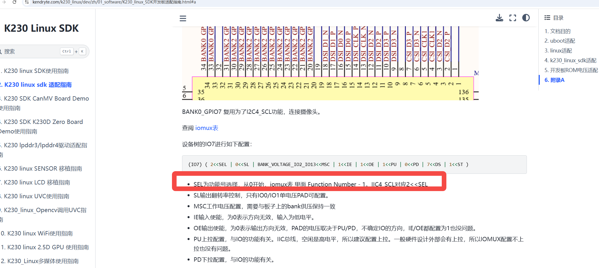

How about edit IO63 ->CAM2_MCLK
#buildroot-overlay/boot/uboot/u-boot-2022.10-overlay/arch/riscv/dts/k230_canmv_dongshanpi.dts
# modify (IO63) ( 0<<SEL | 0<<SL | BANK_VOLTAGE_IO62_IO63<<MSC | 1<<IE | 1<<OE | 0<<PU | 0<<PD | 7<<DS | 1<<ST ) to
(IO63) ( 1<<SEL | 0<<SL | BANK_VOLTAGE_IO62_IO63<<MSC | 0<<IE | 1<<OE | 0<<PU | 1<<PD | 4<<DS | 1<<ST )
#  refer  buildroot-overlay/boot/uboot/u-boot-2022.10-overlay/arch/riscv/dts/k230_canmv_01studio.dts
