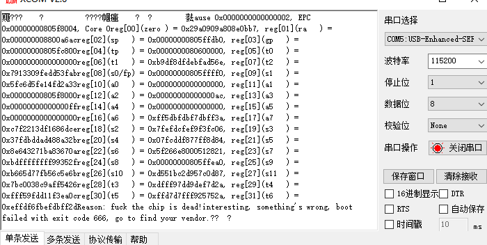

自己焊接的K210板子,启动时候串口报错
Cause 0x0000000000000004, EPC 0x0000000088001560, Core 0reg00 = 0x01a16604a475a509, reg01 = 0x0000000088000a7creg02 = 0x00000000805dfb40, reg03 = 0x00000000805fc800reg04 = 0x0000000080600000, reg05 = 0x0000000000000000reg06 = 0x0000000000000001, reg07 = 0x791b309fe9f56d2breg08 = 0x00000000805dfc70, reg09 = 0x1fc6ddfe30a0a732reg10 = 0x00000000805dfd70, reg11 = 0x0000000000000032reg12 = 0x000000000000001d, reg13 = 0x00000000805dfd70reg14 = 0x000000008800153c, reg15 = 0x00000000805dfc47reg16 = 0x000000008800ba60, reg17 = 0x0000000088008b34reg18 = 0xdfefdcfe79f50cc0, reg19 = 0x37fd3dfad4a8a32breg20 = 0xeffcdff2dfff7d3f, reg21 = 0x8e643271fa03f70ereg22 = 0x5f6a4b8004512021, reg23 = 0xb5fffff7fdb8352freg24 = 0x00000000805ffeb0, reg25 = 0x00000000805ffff0reg26 = 0x1fc6ddfe30a0a732, reg27 = 0x2340030c1aa74122reg28 = 0xdffd97df9ded7d2a, reg29 = 0xd7d5b7f97b2be326reg30 = 0xffffffffe7fd7d6a, reg31 = 0xefbd76ebe7f9ff2dReason: fuck the chip is dead!interesting, something's wrong, boot failed with exit code 666, go to find your vendor.
以下是截图:
上电有时候报这个错,有时候发出几个乱码字符

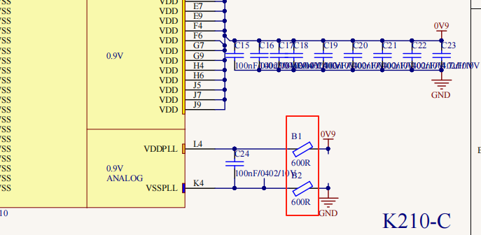

B1 B2两个磁珠,由于我手里暂时没有,我直接短接的,是不是这个原因?
你好,看起来是烧录的固件有问题,可以尝试烧录其他的固件进行测试。
就是无法烧录,进不去下载模式
你好,请问你使用的是自己做的板子吗?
是的
