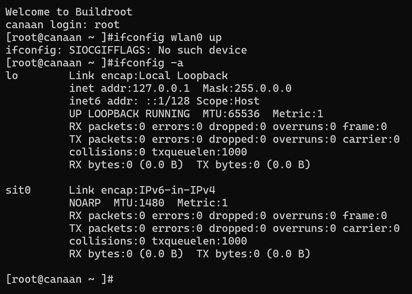

庐山派K230检测不到wifi模块,重启无效
Viewed 152
昨天还能正常连接,今天一起来就坏了
庐山派

还是不行,试了好多遍了。应该怎么排查?
现在是显示出来的,但是根本扫描不到任何wifi,这也太奇怪了吧
ifconfig -a
wlan0     Link encap:Ethernet  HWaddr 00:E0:4C:6D:E8:1B
          BROADCAST MULTICAST  MTU:1500  Metric:1
          RX packets:0 errors:0 dropped:0 overruns:0 frame:0
          TX packets:0 errors:0 dropped:0 overruns:0 carrier:0
          collisions:0 txqueuelen:1000
          RX bytes:0 (0.0 B)  TX bytes:0 (0.0 B)
wpa_cli -i wlan0 scan
OK
wpa_cli -i wlan0 scan_result
bssid / frequency / signal level / flags / ssid
