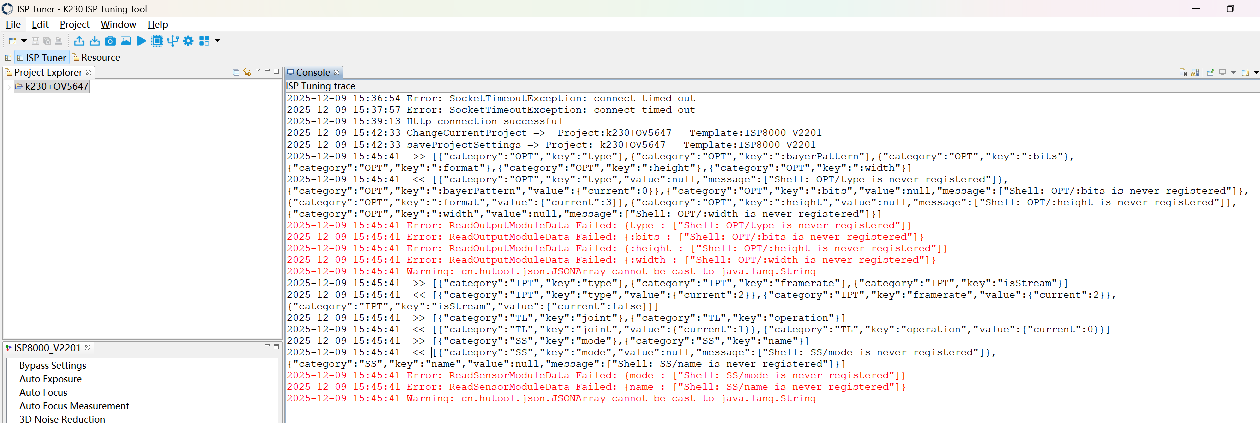

使用ISP Tuning tool出现异常,不能拍摄图像
Viewed 83

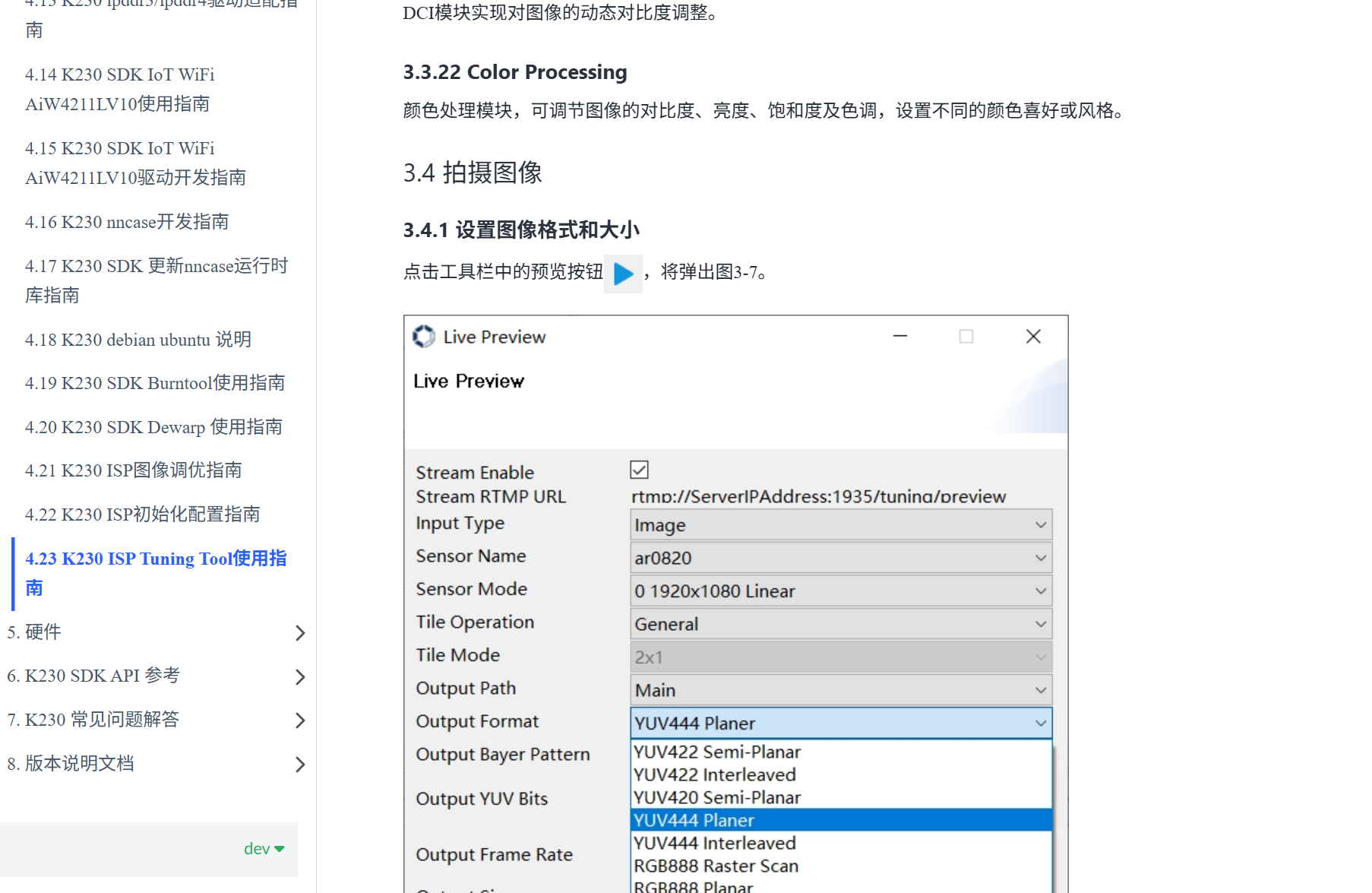

执行教程3.4.1的操作并不能弹出3-7的功能框。以下图片是报错信息

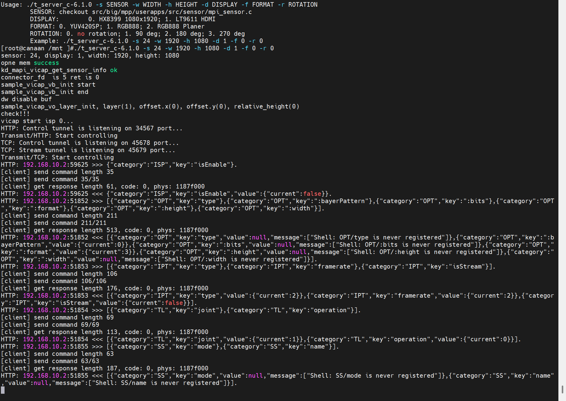

[VENC_S] [Func]:mapi_msg_get_venc_mod [Line]:536 [Info]:###
[] [Func]:mapi_msg_get_dpu_mod [Line]:325 [Info]:###
Enter any character to exit the program!
l^Hconnector_type is 1 connector_info.name is lt9611 connector_info.bg_clolor is 808000
[D/lt9611] vtotal 0 vactive 0 htotal_sys 0
kd_mapi_vicap_start dev id is 0
mirror mirror is 0 , sensor tpye is 21
ov5647_power_rest OV5647_CAM_PIN_CSI2 is 21
[tuning] dev: 0
acq_win.width: 1920
acq_win.height: 1080
pipe_ctrl: 4261412857
sensor_fd: 9
sensor_type: 21
sensor_name: ov5647_csi2
database_name: ov5647-1920x1080
buffer_num: 0
buffer_size: 0
[tuning] chn: 0
out_win.width: 1920
out_win.height: 1080
bit_width: 0
pix_format: 5
buffer_num: 6
buffer_size: 3110912
yraw_size: 0
uv_size: 0
v_size: 0
block_type: 1
wait_time: 500
chn_enable: 1
VsiCamDeviceCreate hw:0-vt:0 created!
kd_mpi_isp_set_output_chn_format, width(1920), height(1080), pix_format(5)
[dw] init, version Nov 6 2024 14:31:08
[server] get message length 35
[server] received 35/35
[tuning] TCommonBufferQueue_open done
[tuning] TDriver_open done
1970-01-01 00:04:20.516000 ERROR src/isp/sdk/t_frameworks/t_driver_c/source/units/driver_units_rgb_infrared_radiation.c:42: TDriverUnits_rgbInfraredRadiation_process(): RET_NOT_SUPPORT(2)
1970-01-01 00:04:20.532000 WARN src/isp/sdk/t_frameworks/t_driver_c/source/driver_pipeline.c:186: TDriver_pipeline(): RET_NOT_SUPPORT(2)
你好,同时测试反馈目前的实现还不支持通过工具进行抓图,建议先使用屏幕预览。。。。后续会在rtos sdk中添加支持。
