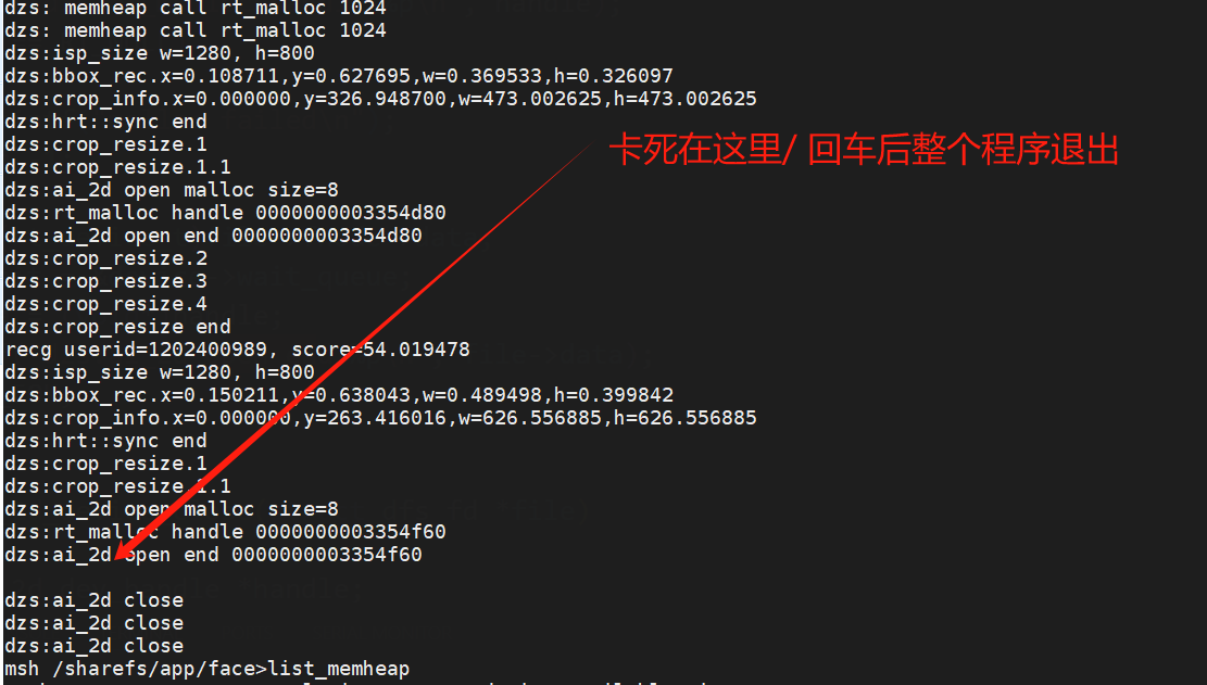

void Utils::crop_resize(Bbox &crop_info, std::unique_ptr<ai2d_builder> &builder, runtime_tensor &ai2d_in_tensor, runtime_tensor &ai2d_out_tensor)
    // run ai2d
    ai2d_crop_param_t crop_param{true, crop_info.x, crop_info.y, crop_info.w, crop_info.h};
    printf("dzs:crop_resize.1\n");
    //auto b = ;
    printf("dzs:crop_resize.1.1\n");
    builder.reset( new ai2d_builder(in_shape, out_shape, ai2d_dtype, crop_param, shift_param, pad_param, resize_param, affine_param) );
    printf("dzs:crop_resize.2\n");
    builder->build_schedule();
    printf("dzs:crop_resize.3\n");
    printf("dzs:crop_resize.4\n");
    //delete b;
这个函数调用2-3次挂机,卡死在 builder.reset( new ai2d_builder(in_shape, out_shape, ai2d_dtype, crop_param, shift_param, pad_param, resize_param, affine_param) );
这行,跟踪了AI2D的驱动
static int ai_2d_device_open(struct dfs_fd *file)
    struct ai_2d_dev_handle *handle;
    rt_device_t device;
    rt_size_t size = sizeof (struct ai_2d_dev_handle);
    rt_kprintf("dzs:ai_2d open malloc size=%d\n", size);
    //g_memheap_log = 1;
    handle = rt_malloc( size );
    //g_memheap_log = 0;
    rt_kprintf("dzs:rt_malloc handle %p\n", handle);
    if(handle == RT_NULL)
        rt_kprintf("malloc failed\n");
        return -1;
    device = (rt_device_t)file->fnode->data;
    handle->wait = &device->wait_queue;
    file->data = (void*)handle;
    rt_kprintf("dzs:ai_2d open end %p\n", file->data);
    return RT_EOK;
这个函数是可以成功返回

在Utils类中修改的。 把剪裁+缩放一起true就不稳定,API手册中这两个是可以组合使用;单独用没问题
