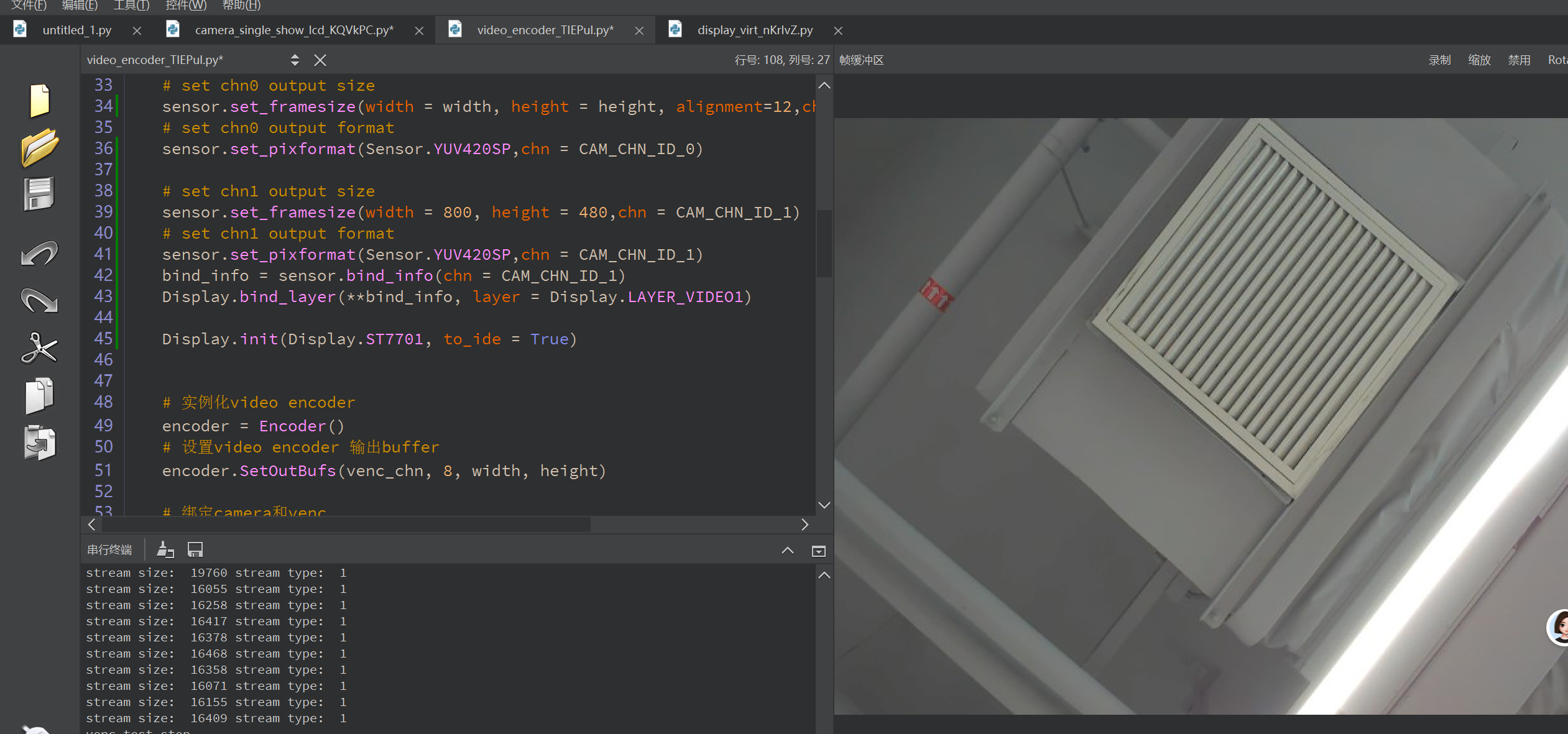

你好,请参考以下示例,实现边录像边实时预览显示的功能。建议最好同步到最新版本,类似MediaManager.init()函数,新版本已经废弃不再使用了。
# Video encode example
# Note: You will need an SD card to run this example.
# You can capture videos and encode them into 264/265 files
from media.vencoder import *
from media.sensor import *
from media.media import *
from media.display import *
import time, os
def vi_bind_venc_test(file_name,width=1280, height=720):
    print("venc_test start")
    venc_chn = VENC_CHN_ID_3
    width = ALIGN_UP(width, 16)
    venc_payload_type = K_PT_H264
    # 判断文件类型
    suffix = file_name.split('.')[-1]
    if suffix == '264':
    elif suffix == '265':
        venc_payload_type = K_PT_H265
        print("Unknown file extension")
        return
    # 初始化sensor
    sensor = Sensor()
    sensor.reset()
    # 设置camera 输出buffer
    # set chn0 output size
    sensor.set_framesize(width = width, height = height, alignment=12,chn = CAM_CHN_ID_0)
    # set chn0 output format
    sensor.set_pixformat(Sensor.YUV420SP,chn = CAM_CHN_ID_0)
    # set chn1 output size
    sensor.set_framesize(width = 800, height = 480,chn = CAM_CHN_ID_1)
    # set chn1 output format
    sensor.set_pixformat(Sensor.YUV420SP,chn = CAM_CHN_ID_1)
    bind_info = sensor.bind_info(chn = CAM_CHN_ID_1)
    Display.init(Display.ST7701, to_ide = True)
    # 实例化video encoder
    encoder = Encoder()
    # 设置video encoder 输出buffer
    encoder.SetOutBufs(venc_chn, 8, width, height)
    # 绑定camera和venc
    link = MediaManager.link(sensor.bind_info()['src'], (VIDEO_ENCODE_MOD_ID, VENC_DEV_ID, venc_chn))
    if (venc_payload_type == K_PT_H264):
        chnAttr = ChnAttrStr(encoder.PAYLOAD_TYPE_H264, encoder.H264_PROFILE_MAIN, width, height)
    elif (venc_payload_type == K_PT_H265):
        chnAttr = ChnAttrStr(encoder.PAYLOAD_TYPE_H265, encoder.H265_PROFILE_MAIN, width, height)
    streamData = StreamData()
    # 创建编码器
    encoder.Create(venc_chn, chnAttr)
    # 开始编码
    encoder.Start(venc_chn)
    # 启动camera
    sensor.run()
    frame_count = 0
    print("save stream to file: ", file_name)
    with open(file_name, "wb") as fo:
                encoder.GetStream(venc_chn, streamData) # 获取一帧码流
                for pack_idx in range(0, streamData.pack_cnt):
                    stream_data = uctypes.bytearray_at(streamData.data[pack_idx], streamData.data_size[pack_idx])
                    fo.write(stream_data) # 码流写文件
                    print("stream size: ", streamData.data_size[pack_idx], "stream type: ", streamData.stream_type[pack_idx])
                encoder.ReleaseStream(venc_chn, streamData) # 释放一帧码流
                frame_count += 1
                if frame_count >= 200:
                    break
            print("user stop: ", e)
        except BaseException as e:
            import sys
            sys.print_exception(e)
    # 停止camera
    sensor.stop()
    # 销毁camera和venc的绑定
    del link
    # 停止编码
    encoder.Stop(venc_chn)
    # 销毁编码器
    encoder.Destroy(venc_chn)
    print("venc_test stop")
    # deinit display
    Display.deinit()
if __name__ == "__main__":
    vi_bind_venc_test("/data/test.264",800,480)  # vi绑定venc示例
    #stream_venc_test("/data/test.264",800,480)  # venc编码数据流示例
