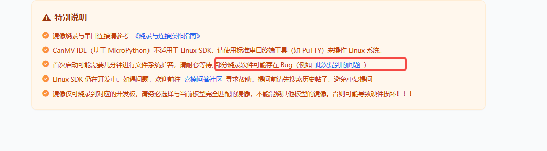

立创开发板 K230使用闪迪tf卡烧录镜像后无法启动
Viewed 85
https://kendryte-download.canaan-creative.com/k230/release/linux_sdk_images/v1.0/k230_canmv_lckfb_defconfig/CanMV-K230_LCKFB_linux_v1.0_nncase_v2.11.0.img.gz
